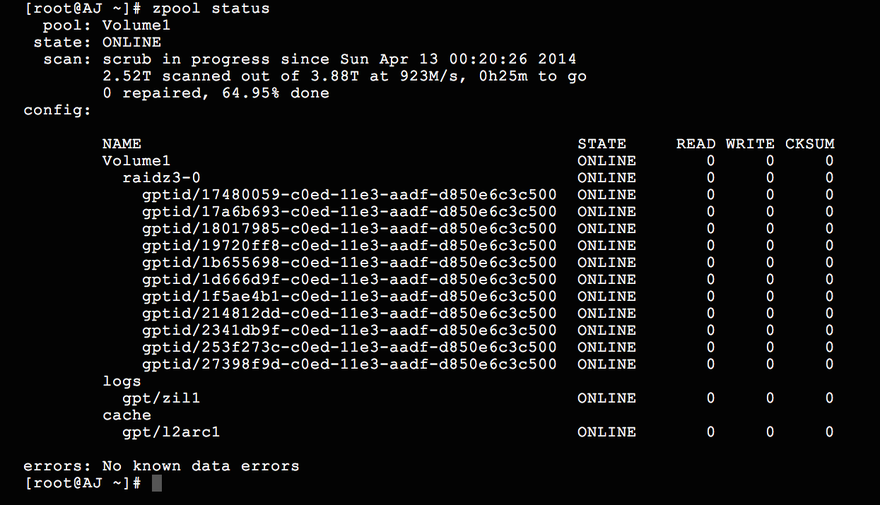

Just completed my first FreeNAS build.
Specs:
Intel® Xeon® Processor E3-1225 v3 (8M Cache, 3.20 GHz) (4-Core)
ASUS P9D-WS ATX Workstation MB (Socket 1150) (4 x DDR3 1600MHz) (Intel C226 Chipset) (6 x SATA 6GB/s) (2 x Intel NiCs)
Kingston 32GB 1600MHz DDR3 ECC ( 4 x 8 GB)
Hitachi 4TB Deskstar 64M 7200rpm HDD x 11 (in RAID-Z3)
Fractal Design Newton R3 600W PSU 80+ Platinum Smart Modular
Fractal Design Define XLR2 Full Tower Black
Samsung 840 Pro 256 GB SATA 6GB/s SSD ( L2ARC & ZIL)
LSI 9211-8i HBA SAS SATA 8-port PCI-E 6Gb/s RAID Controller Card (Got this cheap off ebay, seems to be working fine till now but I am still a bit suspicious if its genuine. HDDs seem to burst write every second instead of continuous operation)
Here is a pic of the final build. Its not the cleanest but it does the job. The stack on left is running a bit hot cause I think the front intake fans arent blowing in as much air. So I have ordered an extra couple of high airflow fans to help cool things a bit.
The whole setup cost about $5000 ( I know, Australia) and has put a big dent in my savings (as I still am a uni student). Anywho, it seems to coping fine till now. In terms of speed, I havent really had the chance to test it fully as I still have to get some cat6 cable. I did transfer about 3TB data over WiFi (phew!) and scrub ran at about 750MB/s so that okay I think.

Everything looks nice.. but the l2arc and zil scare me.. for one, you probably are hurting performance with an l2arc(yes, this is possible and happens more often than not because people don't understand how the l2arc works and when it helps and how it can and does hurt), but your lack of a mirrored ZIL.. wow.. good luck with that. And unless you are using NFS with sync writes, the ZIL is useless.
I wouldn't have gone with an Asus board. It's really not ideal for a FreeNAS box. It's got onboard audio and whatnot that is useless, but will use power forever. Even if you disable it in the BIOS, it will use power.
Beautiful pictures though.

@cyberjock I'm not really concerned about power consumed by the audio ports etc because while I tried to minimize the power draw, I wont be running this 24x7, just as needed. Plus as this is a pretty powerful build, I might just add in a gfx card with another boot drive later and use it for gaming or something else. (this is just a maybe but its good to have options haha). In terms of the l2arc and zil, didnt zfs fix the problems of loosing data from the zil? Well its not critical data anyway so I guess it doesnt matter that much and power is pretty stable around here. What are your recommendations though? Currently I just have one ssd.
What problem? The ZIL stores data that isn't in the pool.. so if you lose power there is only one copy of the data that may exist... the data in the ZIL. So no, redundancy has always and will always still be recommended heavily forever.
