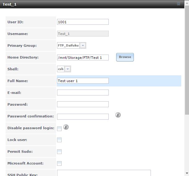

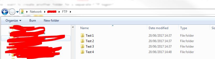

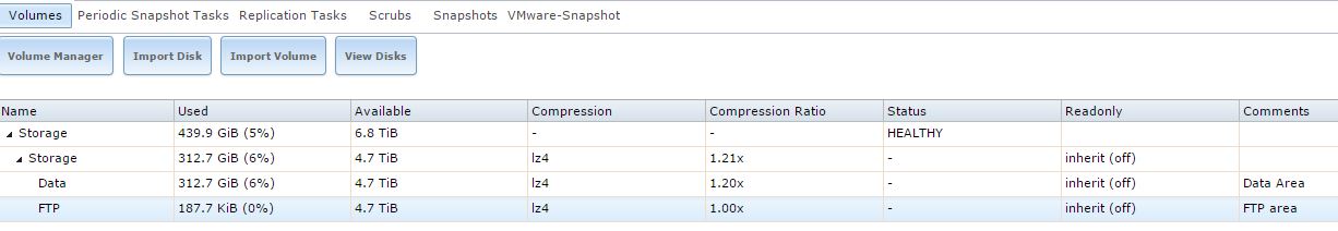

Hi guys,
Ok so at the moment i FTP (Filezilla Server) setup on my DC (Windows Server) which i want to move, so i thought I'll put it on the Freenas server I've just installed.
Followed some instructions and seems to be working OK internally on the main FTP dataset (set a Windows Share for the FTP dataset). I just need to change setting in our firewall so uses the External IP address for the freenas server instead of the DC, then it should work externally.
On Filezilla, I can simply create a folder in the FTP area, then create an accounts and attach the folder I created with the FTP share, so external people can access but also be restricted to certain folders I've assigned to certain accounts. I have multiple folders with accounts for each.
On Freenas, do i create an account and create a folder like in the Filezilla and the select the required folder created within the FTP share itself (Dataset) or do I have to create a NEW "Dataset" within the FTP Dataset every time i want to create another folder for a separate FTP logon?
Basically do i set it up the same way and I would like to keep the permissions for the Windows share on the folders, I've attached some screenshots.
Thanks
James

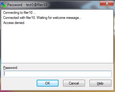

Forgot this screenshot telling me "Access Denied" when putting the password in through WinSCP FTP software, the password is right and triple checked it.

OK so I've come to the conclusion that your right SweetAndLow, doing a bit of testing and I creating the folder in the FTP area (Windows Share), made a user on the Freenas server and put the Home Directory pointing to the FTP share. Then it creates a folder inside the FTP share, GREAT!! :):).
The only problem I've got is when i try some FTP software to connect, it gives me "access denied" unless I add "Everyone" in the Security tab in Windows, which I'd rather not if I can avoid it.
Is there anything else I can try to get it to work with Windows security groups and Freenas users, so I don't need everyone??
Thanks
James
