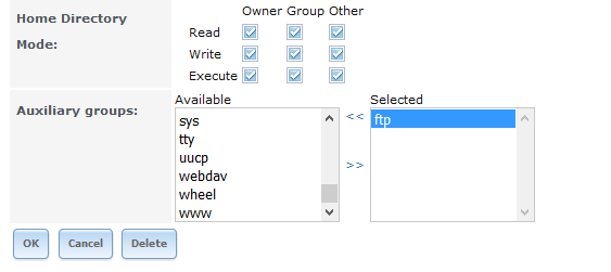

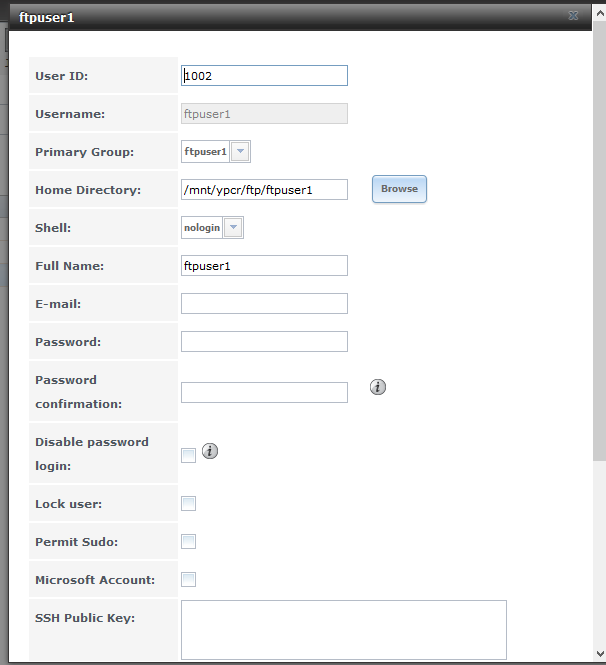

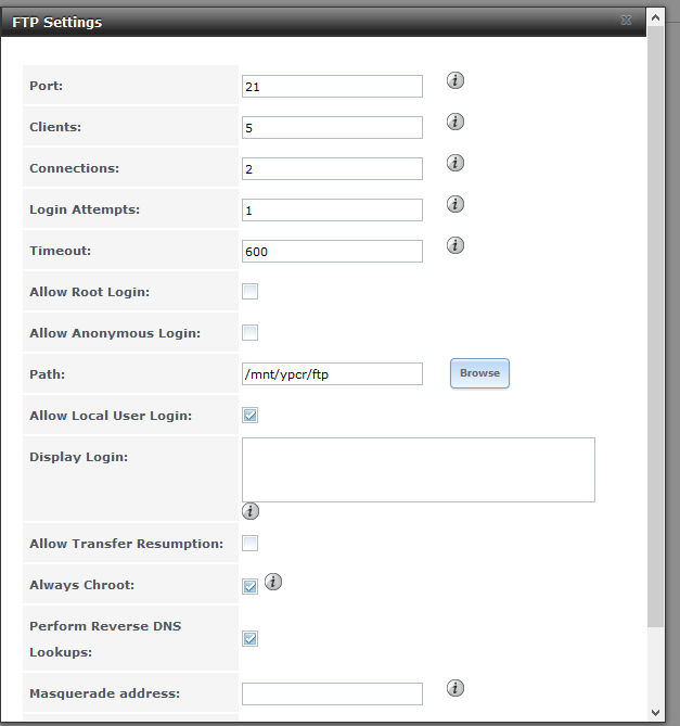

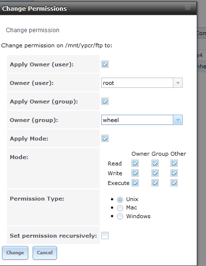

/mnt/ypcr/ftp is owned by root (screen shot attached) could this be why sub folder access is not working after creation? I wanted to have multiple users locked into there home folder, so would I need to create an ftp-only group and assign it full permissions? I have tried doing this on the command line using the ftpuser1 group that was created when the ftpuser1 account was setup.
chown -R ftpuser1:ftpuser1 /mnt/ypcr/ftp/ftpuser1
what would you suggest to get each account working only within it's own home folder SweetAndLo.
tim

When you first login over ftp you are in the directory that you specify as the ftp root under the ftp service settings. I think you are just in the wrong directory when you are doing stuff. I think for some of your tests you are in the root and others you are in the users directory. The screen shot where you showed that /mnt/ycpr/ftp is set for 777 permissions will allow you to ftp in and run a mkdir and cd into that directory. If you say it doesn't work that is because you are in the wrong directory.
But you probably don't want all users to use the same directory do you? So you should change the ftp data set back to root:wheel and 755 then create user directories for everyone with permissions of 700. This will prevent people from writing to root of the ftp and only allow them to write to their directory and not see what other people have in their directories.
