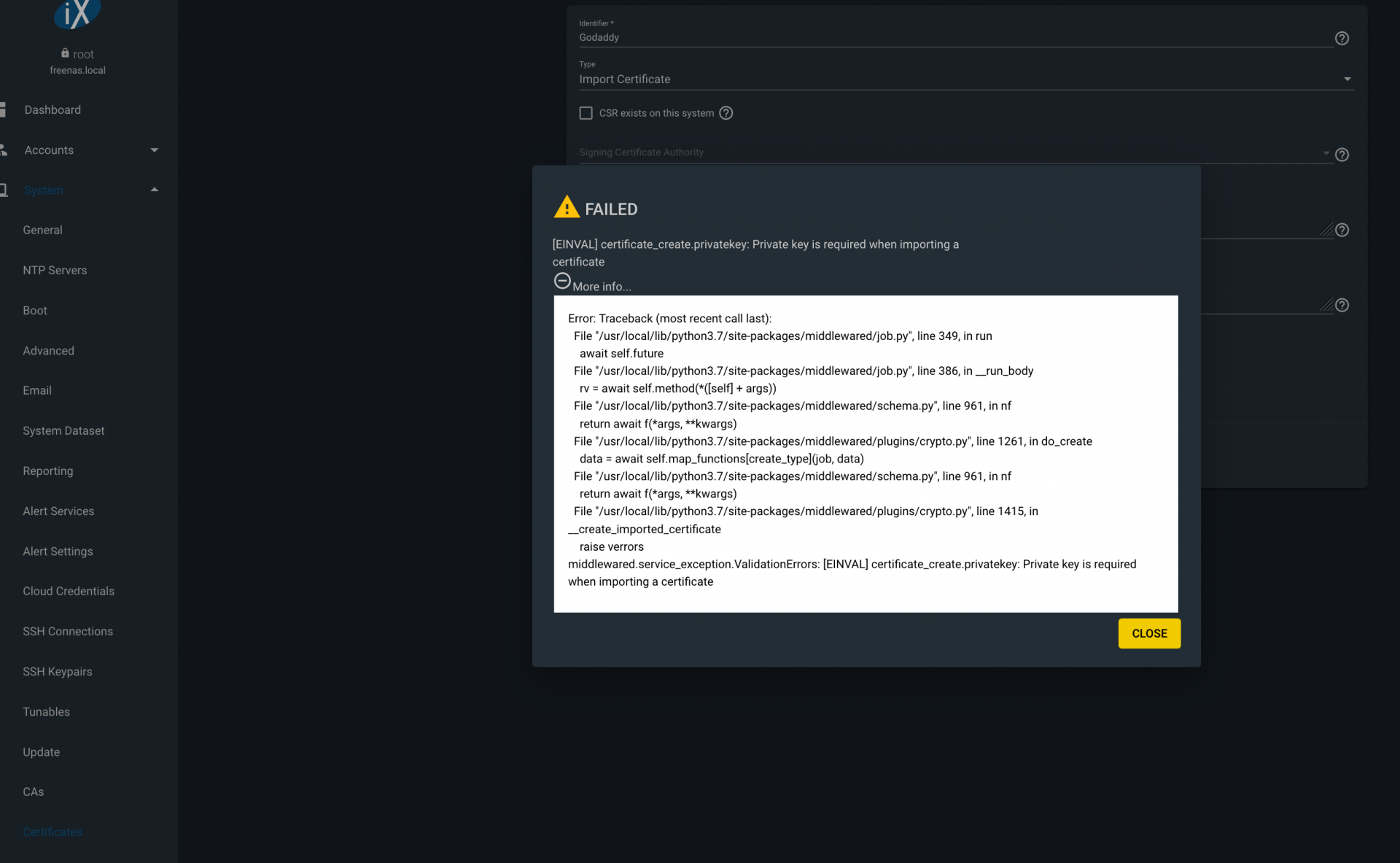

Dear all,
Based on this guide:
I tried to setup the Godaddy certificate in Freenas but it requires a private key which I do not have ?
Further I ignored and skipped the cert. part- with ldap encryption on and verfiy cert. off it seems to work....Can someone explain why ?

I also tried that indeed and it works BUT It does not show up under ldap as available certificates...
anodos
Sambassador
Mar 6, 2014
9,554
That's because CA certs aren't supposed to show up there. Jumpcloud's documentation is wrong / out of date the last time I checked. All user-provided CAs are automatically added to the LDAP cacertfile.
