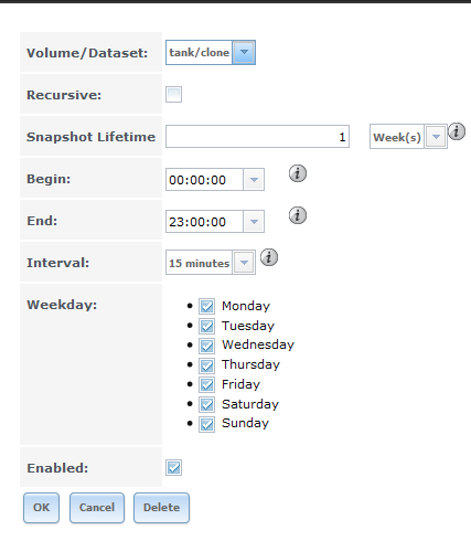

Thanks for prompt reply, let's see if you can spot my error.
Let's start from the setup: there's a dataset (tank/clone) on machine A which I would like to keep replicated on machine B (tankbig/clone).
The replication process succesfully copies the tank/clone dataset to the tankbig zpool, and creates automatically the tankbug/clone dataset on B.
The snapshots on A fire every 15 minutes. Just after the replication ends succesfully (after 4h+), letting a couple minutes it starts again from 0% and lasts again 4h+
This even little changes are happened on what is inside dataset - let's chaging a couple of word documents.
I've attached screenshots of the snapshot and replication tasks on A.

I think i might see a hint of the problem:
- auto dataset snapshot every 15 min, keep for 1h (replication lasts 8h +)
(i notice that your screencaps say 1 week? is this the same snapshot?)
why are you only keeping for 1h? this means your network has to transfer 100% of the replica in under one hour
zfs replication incremental runs as one snapshot compared to another, sending the differences
you must have an existing snapshot for incremental identical across replication servers. if you are keeping snapshots for one hour, I would guess you are erasing all replicated data every hour. i think the in-process replication would complete sucessfully, the snapshot deletes as its not in use, and...it replicates the entire stream again because you have no snapshots in common anymore.
incremental backups usually work based on tiered copies
ie
1 snap per week for 1 month
1 snap per day for 1 week
1 snap per hour for 1 day
you could probably make a manual snap,then let it replicate every hour, and delete the manual, but if something messes up the replication rotation for an hour you would lose the whole replica sync and have to start from scratch.
snapshots generally have no performance impact (unless over something like 5000 depending on hardware) and only use space for changes since the last snap so I'm not sure why you would want to gimp a zfs feature so much.
fwiw at the command line the replication would look something like this: (syntax may be a bit off)
zfs send -I tank/clone@auto-20170317.0903-2m tank/data@auto-20170318.0945-2w | ssh root@192.168.1.200 'zfs receive tankbig'

The same idea occurred to me... but the OP posted an image of his snapshot settings, which show that he's keeping them for a week.
ya i noticed that after writing it all up lol. i crammed a note in about it :/
I think i made the same mistake myself learning how it all worked.
also had 2 dataset replicas nuking each other due to giving them the same location like a total noob.
