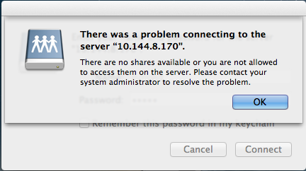

I and my work is new to freenas. We are trying to set it up as a Time Machine backup for Mac. So after I have added 11 users and 12 shared folders I can't connect to the shared folders. I can't even connect the Time Machine to the shared folders either.

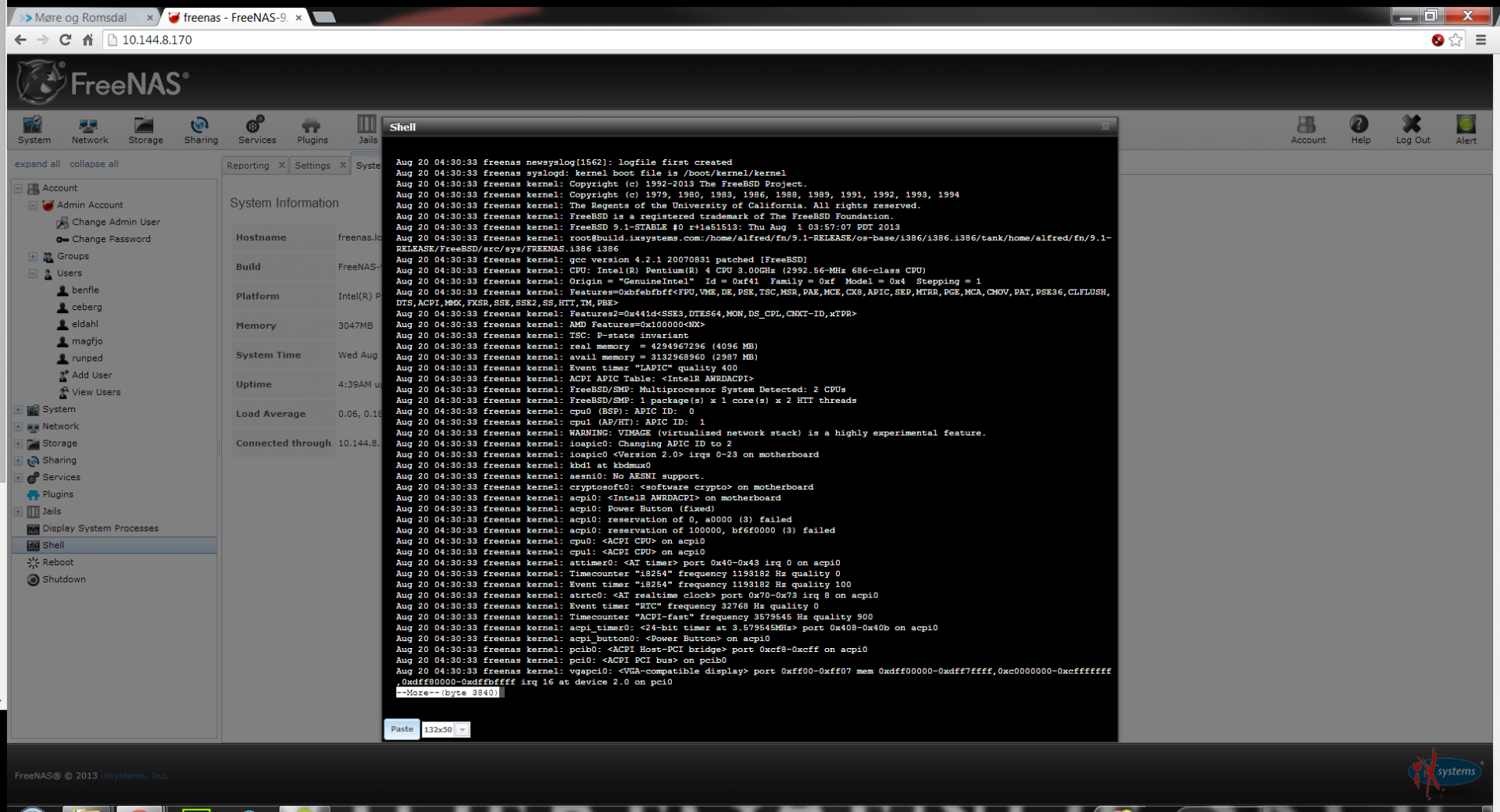

It really depends. Can you at least access the web GUI and the shell?
Also, check /var/log/messages for any errors.
Here's the command, just in case: cat /var/log/messages
If it rolls too fast do: cat /var/log/messages|more
That will let you scroll through it slowly.

Yes, I can access web GUI and shell.
I can't see any problem when i se the log. But I'm not an expert on Freenas.
The second image is the error I get when I try to connect to the freenas from a mac after a while.

The first image doesn't seem to show the whole message. If you look at the bottom, it indicates that there are "more" lines. You can scroll it down with the down arrow key.

Helo, I have scrolled down the message. And this is the eorrrs/warnings I get:
Aug 20 04:30:33 freenas root: /etc/rc: WARNING: failed precmd routine for vmware_guestd
Aug 20 04:30:47 freenas avahi-daemon[2168]: WARNING: No NSS support for mDNS detected, consider installing nss-mdns!
Aug 20 05:44:47 freenas avahi-daemon[5121]: WARNING: No NSS support for mDNS detected, consider installing nss-mdns
And several different IP-adresses that is Invali:
Aug 20 06:10:55 freenas avahi-daemon[5121]: Invalid response packet from host 10.144.8.17.
Whattteva
Mar 5, 2013
1,824
I don't see anything particularly bad. Just out of curiosity, are you virtualizing FreeNAS?

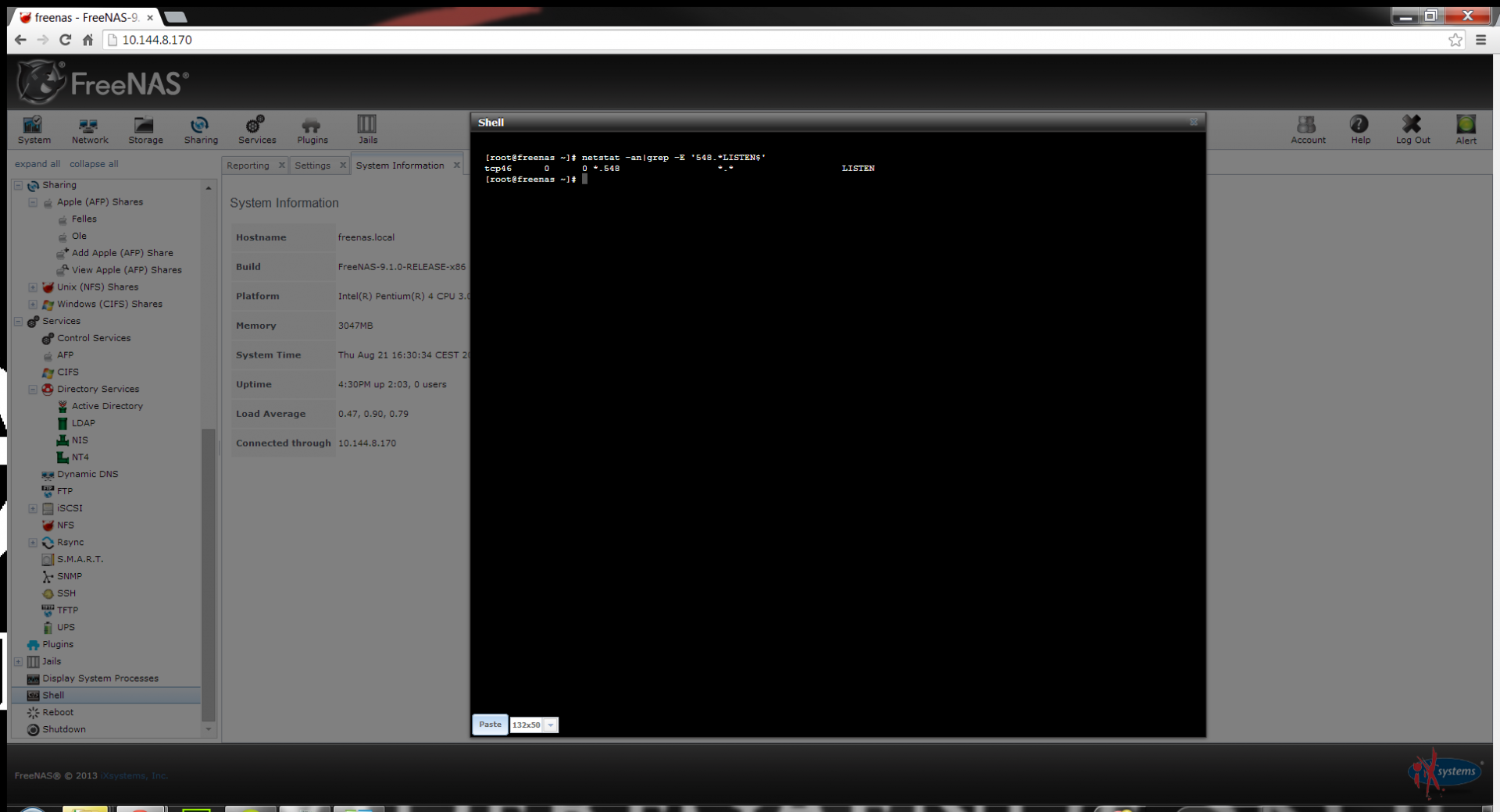

While AFP service is on the ON position, execute these commands on your shell and post the outputs:
ps -ax|grep afpd
netstat -an|grep -E '548.*LISTEN$'

Here is the new message:
Whattteva
Mar 5, 2013
1,824
Service looks fine. I'm guessing it's permissions. Is it viable to use other protocols just to see if those work?
