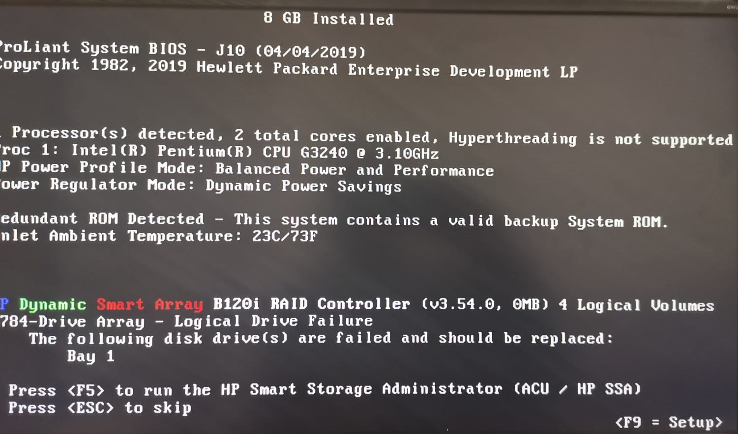

I noticed theres a drive failure log from raid controller. while I was booting up.
The issue seems to me, is that when i reneabled raid, it had 3 drives plugged in, including the OS drive, which was not in the original Raid 1 config

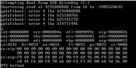

So i plug it back in and boot and i get the following errors.
You are right, the issue is raid configuration, so now i will try to reconfigure the raid as original raid 1 config, with just the 2 1xtb drives.
