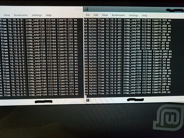

I figured it out. I have a Tyan S7012 motherboard with 4 Nics built into it. I load balanced all 4 of them in FreeNAS. Not sure if that's an issue or not because I can ping the FreeNAS box without and issues. The VM was attached to those nics and it was having the issue. So I installed another Nic just to test. I attached the VM to that 1 nic and issue solved! Works perfect, pings perfect no more pausing. So now it's trouble shooting time.
Either it's the 4 onboard nics which I don't believe is the issues because FreeNAS works perfect. Or it's the Load Balancing on those nics that's the issue. I'll have to do more research, but adding another nic and attaching it to the VM works perfect all my issues are gone.
I'm attaching a picture of what was going on. The Left ping was the FreeNAS box, the Right ping is the VM on that FreeNAS box just crazy ping rates. The only thing you can't see in the picture is the pauses... It would ping about 5 or 6 times then pause for about 3 or 4 seconds then continue on, but you can see by the ping where the pauses where.
