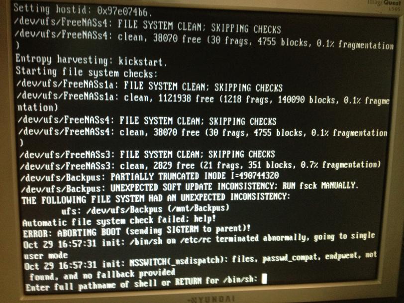

I'll take your advice now depues (because now I will be doing a fsck as it has failed again)
I attached a picture of the mistake that just gave me for help if.
Is there no way to do disable the disk check?
The computer does not restart, is with a UPS.
PS: Sorry for my bad English.

The disk check can't be disabled because it is necessary to minimize/prevent corruption of the file system.
You have something terribly wrong with your setup if you are getting that error regularly. You really should investigate the problem before you find yourself losing data.

I think one or more of the hard disks on that storage volume is bad. The "alerts" in the web-based FreeNAS GUI might be able to help you identify which disk is bad. You might be able to clone the bad disk using ddrescue to a new disk and switch disks to see if that helps. It does look like a bad drive if FreeBSD has to do fsck's again and again.
