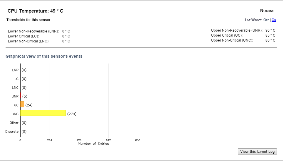

I will try to extract all the information I can. I am quite new to this, so any help and guidance is greatly appreciated. So thank you for taking the time to answer.
General information about my system:
Running NF 9.3-STABLE, latest update. Could it be my powersupply is not able to handle the load of the systemscripts running?
I was able to reproduce the issue tonight. Got the same "security run output" message at 03.01 as before. However, since replacing the boot drive it now correctly reboots and no longer targets a storage-drive when booting.
It acted kind of weird when I got up and tested it today though. When I went to check if it was running, at first I was not able to connect, but a few seconds after, I connected. When I went to check uptime, it said 1 min. As if it had booted just when I started testing. It takes way longer then that to boot though. This seemed odd to me. Is there any sleep mode or something similar that I may have overlooked?

TuxedoCyborg

I have done some more searching, and in the ipmi I am seeing some overheating events. The timestamps of these events do not seem to correlate with the time when I have experience reboots. The asrock board may not have time correctly set though.

Even without proper timings, that looks like pretty conclusive evidence that over-heating is causing your reboots. Or at least some of them!

Yeah, seems very likely. It may be placed in a non-ideal place to stay cool atm. Will report back after trying to cool it down abit.

After moving the system to a better ventilated area, things seem to have improved alot. Running now with 3 days uptime. If things start acting up again I will try with another PSU, thanks for the suggestion Robert.

I'm gonna make a suggestion, add a fan to the CPU heatsink i believe other users here have done that to curve issues with overheating, also how much airflow do you have through your case?
