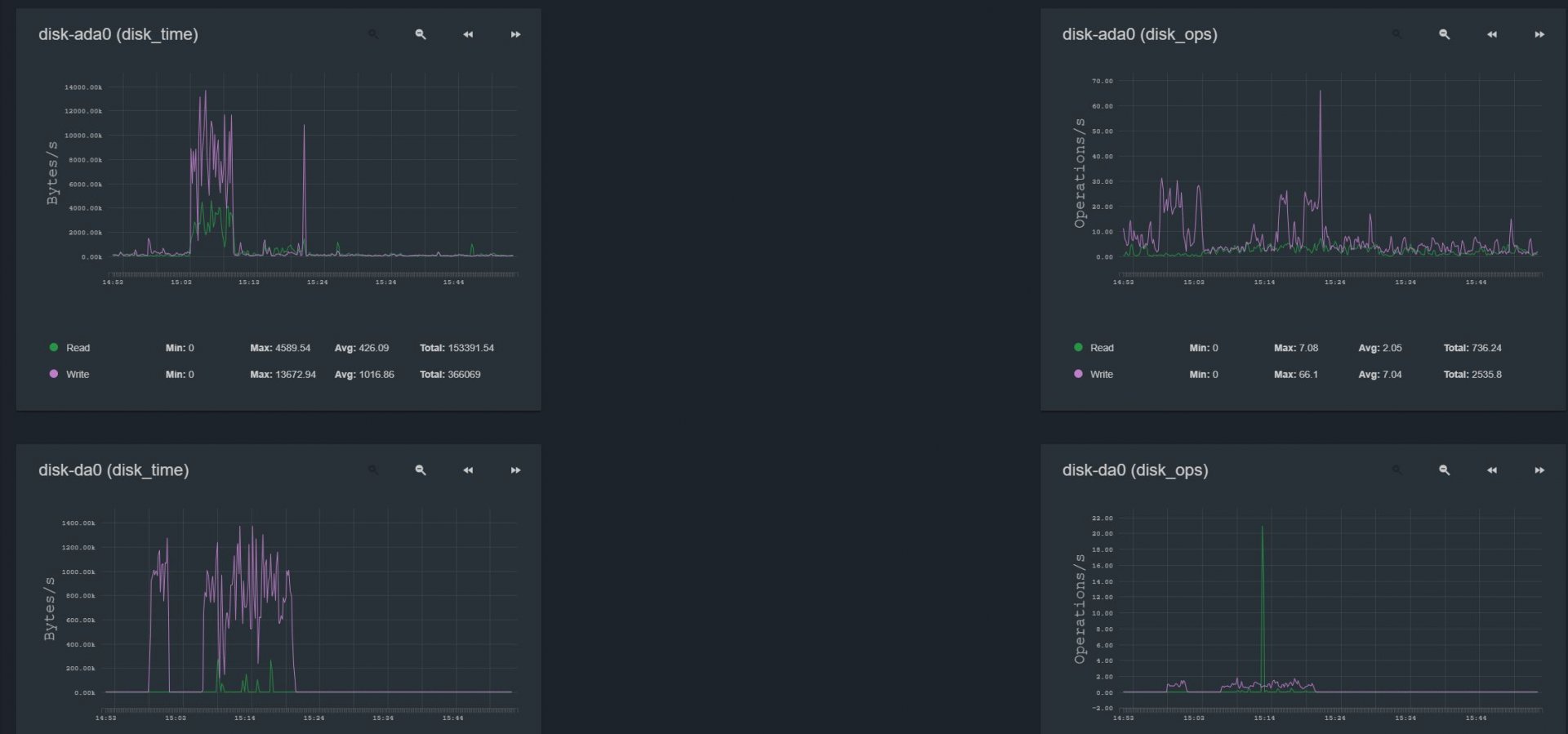

So i have some problem with performance of system operations, especially in docker container created.

And it hangs for 20-30 minutes, with CPU load around 0.5% I thinking that problem in slow USB system stick, so i check "Reporting" tab open DISK and check "operations" parameters, it is zero, no operations, for both system and pool drive.

On picture ada is pool disk, da is system
