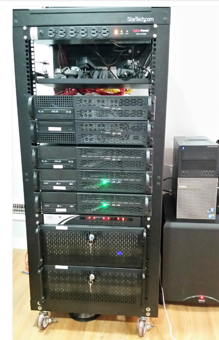

It may not be what people here wold recommend here as it is not hot swap, but for my home use I bought two: https://www.amazon.com/gp/product/B0091IZ1ZG/?tag=ozlp-20. They do have a 12 bays hot swap, but I wanted room for expansion and didn't mind power down the server for HD swap and or addition.
With https://www.amazon.com/gp/product/B00COIZTZM/?tag=ozlp-20
I've used an ASRock Extreme 6 with 10 SATA ports, so didn't need the M1015, but did it anyways for the sake of learning.

Yeap that's a nice one. In my case I needed one for the rack.
