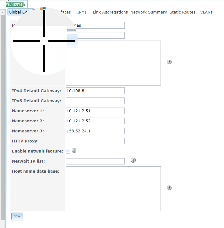

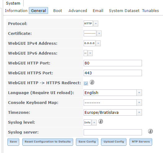

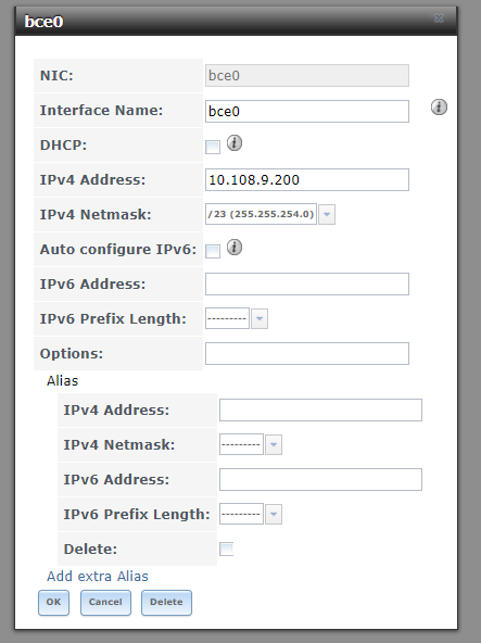

Sure - sorry, I should have been more specific. System-General, Network-Global Configuration, and Network - Interfaces I think would be a good start.
steelbull
Jul 8, 2018
7
Its OK :smile: Im sending screenshots. The network configuration I think is right. I have access from freenas to the network and also to the internet. Most clients are working but some of them are blocked by MAC address.

j0hnby
Apr 22, 2017
68
Thanks - it' was mainly a sanity check. When you change the client's MAC - do you get a different IP? Just working through a thought process and work out what changes apart from the MAC.
As far as I know, the vanilla install doesn't have any filters in place so if you haven't manually put something in should be OK.
