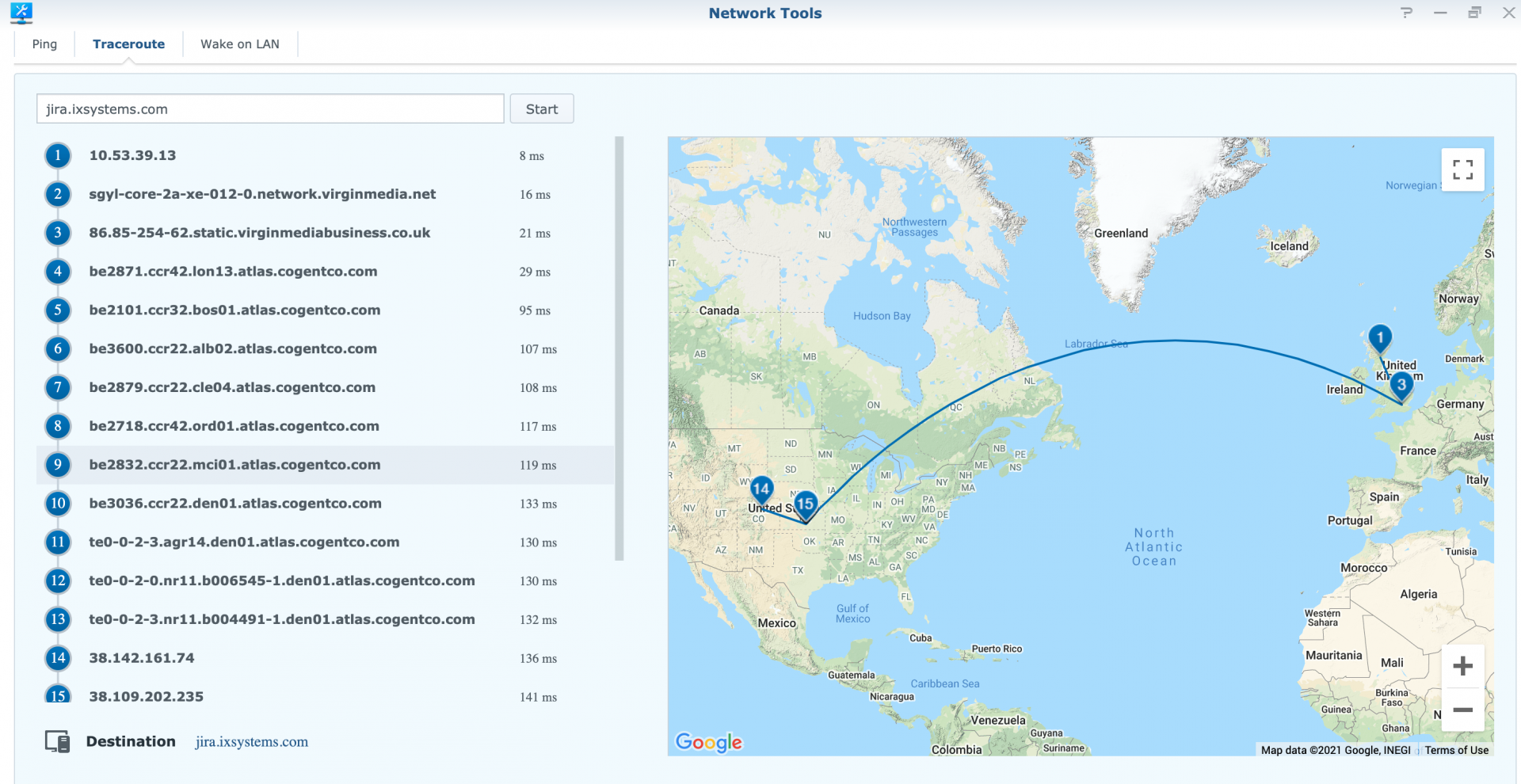

It's always painfully slow for me in the UK on Virgin Media
