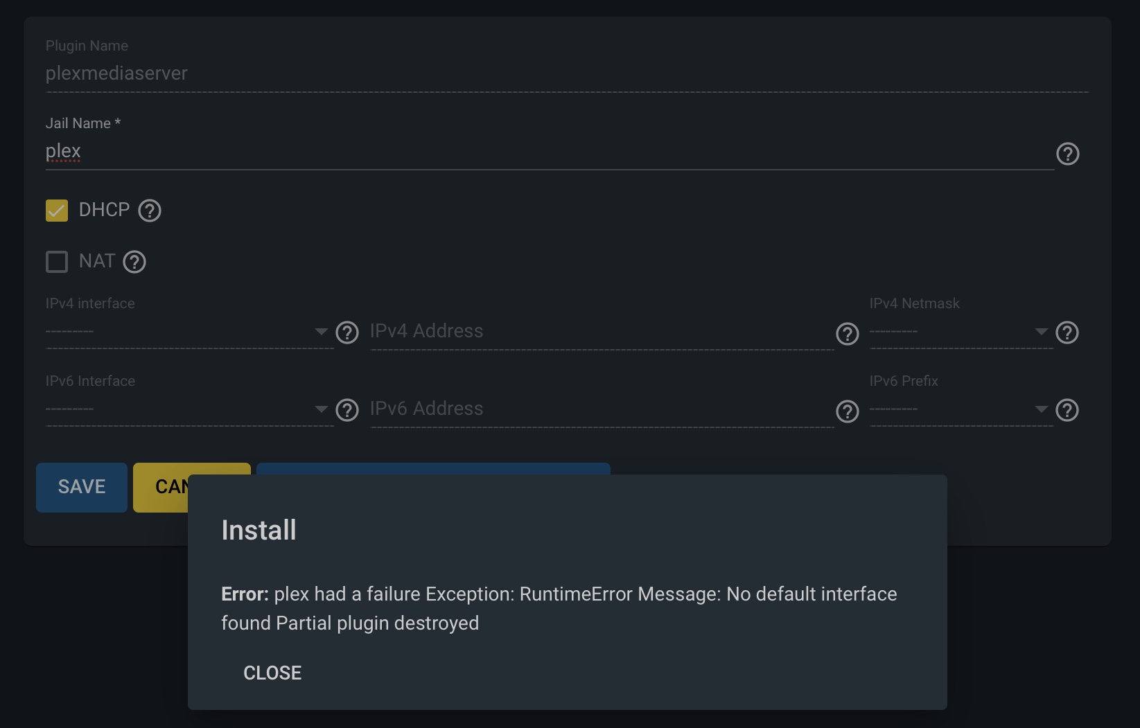

Will the Plex Script work on 11.3? I'm having issues installing the Plex Plugin, so, I'm curious to try other options. I don't want to hijack this thread for my issues.
I just installed the Plex plugin this weekend. What is the problem you are having?

If I just try to install with just basic DHCP, I get this error. When I try a Static IP, I end up a DNS error. When it tries to communicate with Plex.
Weird, I didn't have that error. I was asking because I thought you had the classic permission error after mounting the storage; which I fixed following directions on this post: https://www.ixsystems.com/community...to-install-plex-in-a-freenas-11-2-jail.19412/
You can follow the same post to install Plex using a regular Jail, which is really simple and gives you the ability to update Plex regularly vs the quartely (I believe) plugin update schedule.

I figured my problems out. Both of my errors were tied to network settings. Because I have two routers, it was difficult to get the right settings to let everything work together. Thanks to going through Uncle Fester‘s guide, I also found a few steps I’d skipped along the way that also contributed to some issues. Appreciate everyone’s help.
