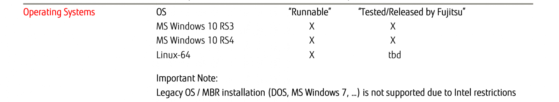

An interesting point in the board documentation: (http://www.braemac.co.uk/images/fujitsu/Fujitsu update 2019/DS-D3641-S.pdf)
Linux not officially supported yet and no mention of FreeBSD
Maybe you can look at disabling onboard components in the BIOS to see if you can get it to boot further.

I saw the table you've posted in your edit, but it seems to be no problem for another Fujitsu Board which is used in this (german) tutorial:
As far as i see, the only difference is, that this board is more for industrial use (Serial Ports, GPIO, 2nd LAN Ports).
