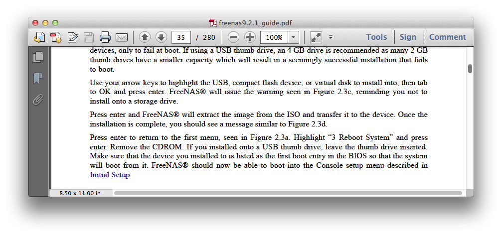

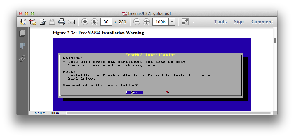

15,504
Well, I only got about 35 pages into the manual, but I found this:
and this (in section 2.3):
and this:
A $10 USB stick will solve your problem, though it's sounding like a SATA DOM will be a better bet when 9.3 is released. However, 9.3 is also said to drop UFS support, so if you aren't using ZFS you won't be able to upgrade.
