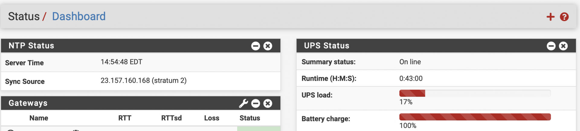

Curtis
Jun 2, 2019
590
not all firewall have an NTP function, hence I am trying to build my own.
Then consider stepping up your game and switch to open source enterprise class software https://pfsense.org for your firewall. Runs on almost any x86 HW or you can buy an appliance from Netgate or https://protectli.com
The other option is see off your existing router can be re-flashed to open source firmware from https://openwrt.org or https://dd-wrt.com, both of which can be configured to serve NTP time on your LAN.
