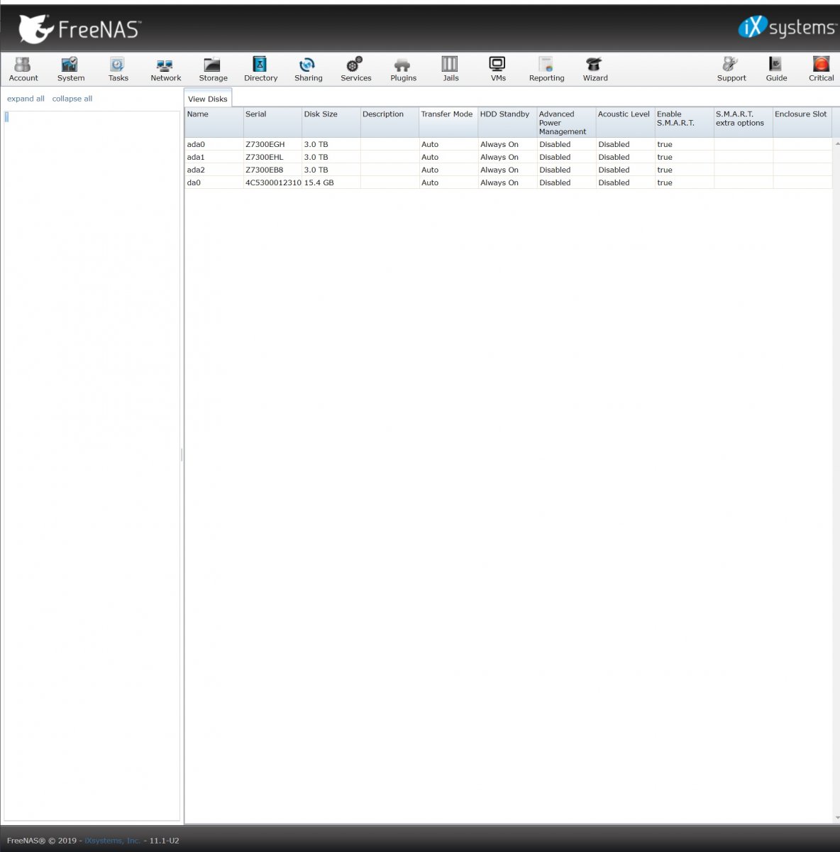

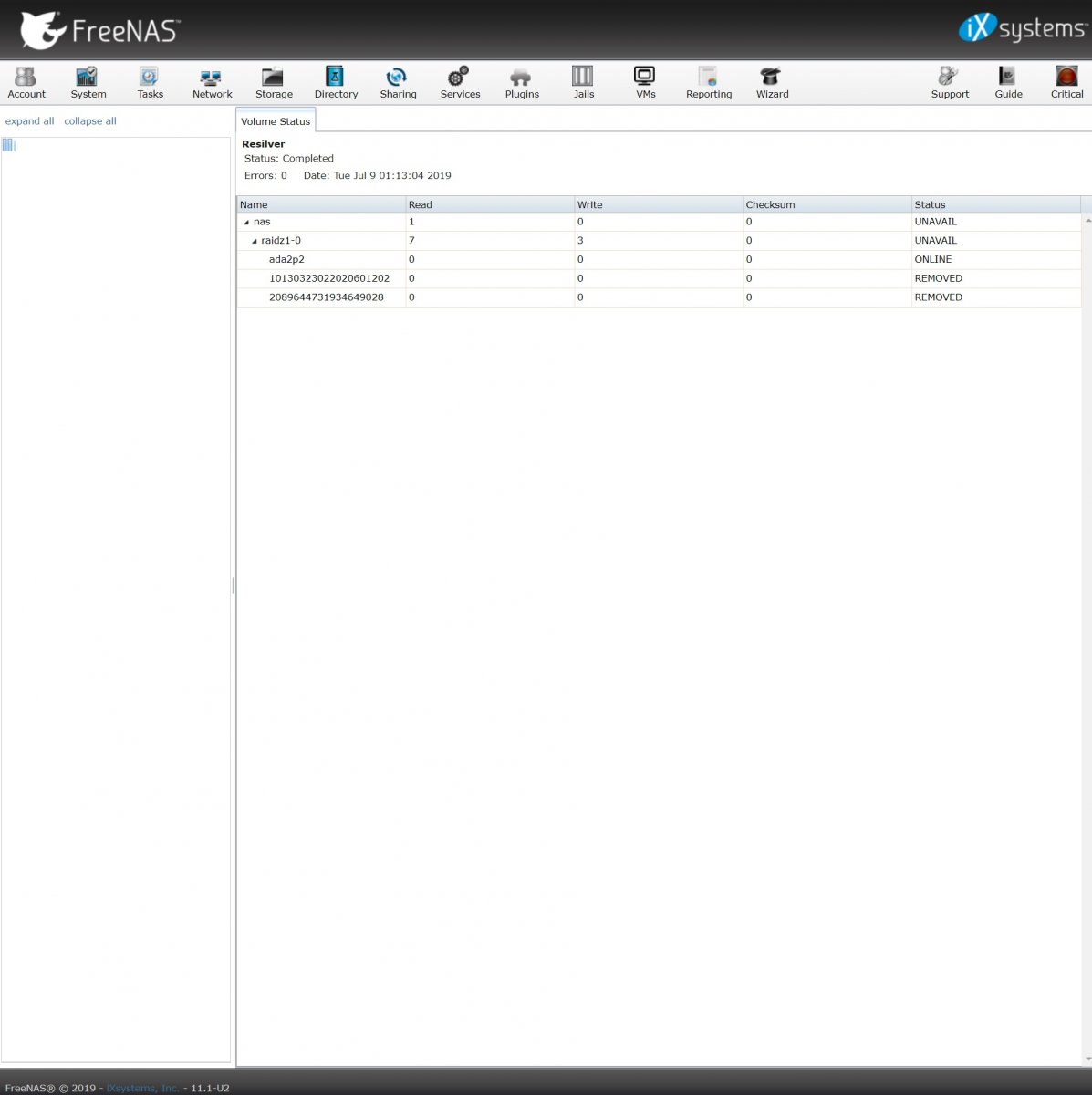

Can someone help me pls
My freenas crashed!
I have 3 drives and all are visible in "View Disks"
But only 1 is online in my volume ( sometimes it changes which one)
Also the left menu won't load
How can i fix this and restore my files
I am a nood so pls if possible simple explanation
Thanks

Which FreeNAS version?
Also, post the full output of zpool status within code tags.

Thanks for your reply, new update so far.
When I remove the ""broken"" drive the nas came back online. So I made a back up off everything and tried to put back the drive but then it stopt working again. I checked the drive on my pc en formatted the drive, on pc it looks like it works normal. After formatting I put it back in the nas but everthing stopt working again. I have now orderd a new HD and hope that it works with that one.
