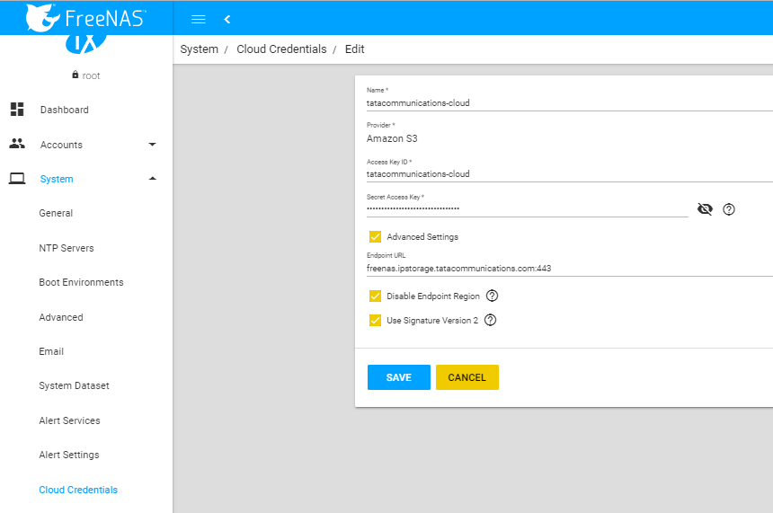

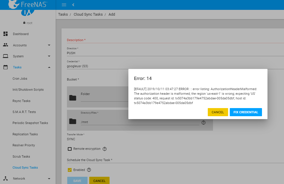

Hi Team,
We are using Swiftstack object storage. it is similar to Amazon S3. Normally Amazon S3 API will be supported while using "Signature V2 option" & "Disable Endpoint regions". Because In Swiftstack, we don't have a region option to configure.
We need your support to find the below error & issues. I don't know, Why this error throughing on it.
[EFAULT] 2019/10/10 19:27:44 ERROR : : error listing: AuthorizationHeaderMalformed: The authorization header is malformed; the region 'us-east-1' is wrong; expecting 'US' status code: 400, request id: tx40a5e21430a14e3f942bf-005d9f38d7, host id: tx40a5e21430a14e3f942bf-005d9f38d7
The same approach we are using on Cyberduck client tool. it is working well. But Here in FreeNAS, it is not working.

Hi Team,
This is the error, we are getting.
This is the configuration, we have given on cloud credentials.

If you make a feature request for Swiftstack at bugs.ixsystems.com, post the issue number here.
