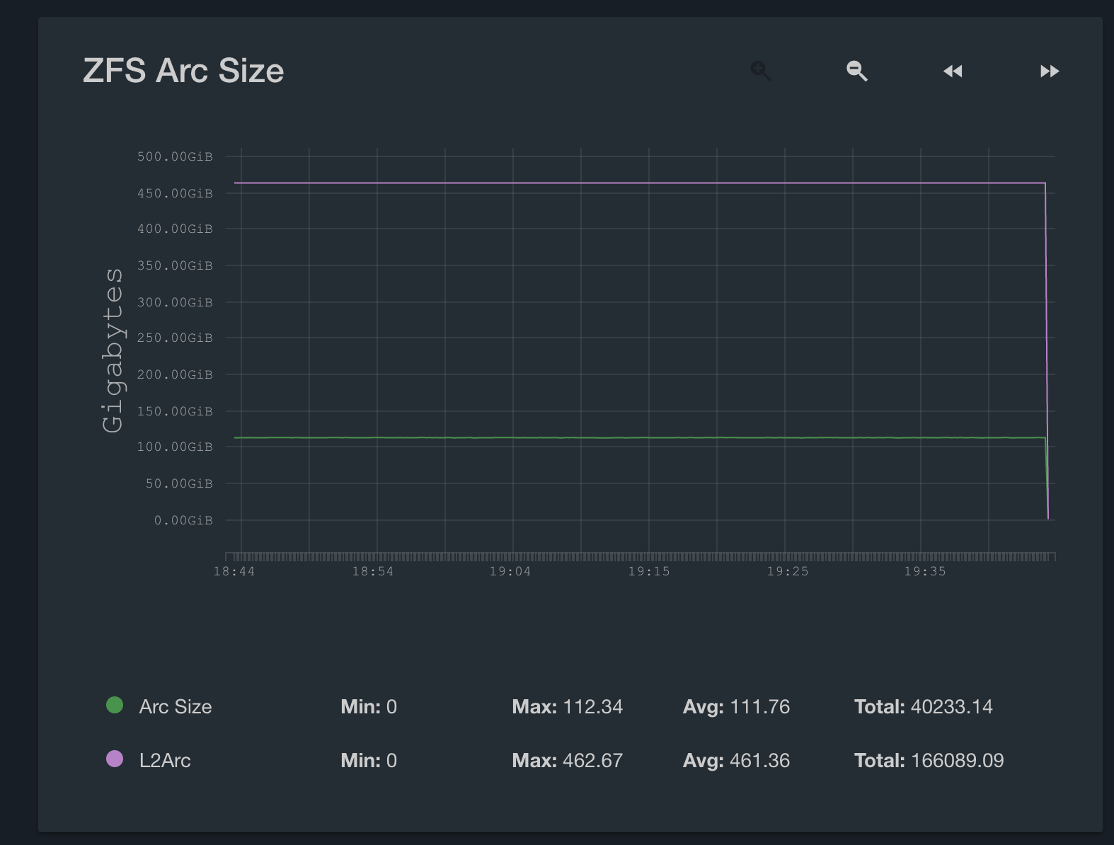

NVME is used for the ARc cache.
I tried to mirror 12 vdev but nothing or little or nothing changes ..

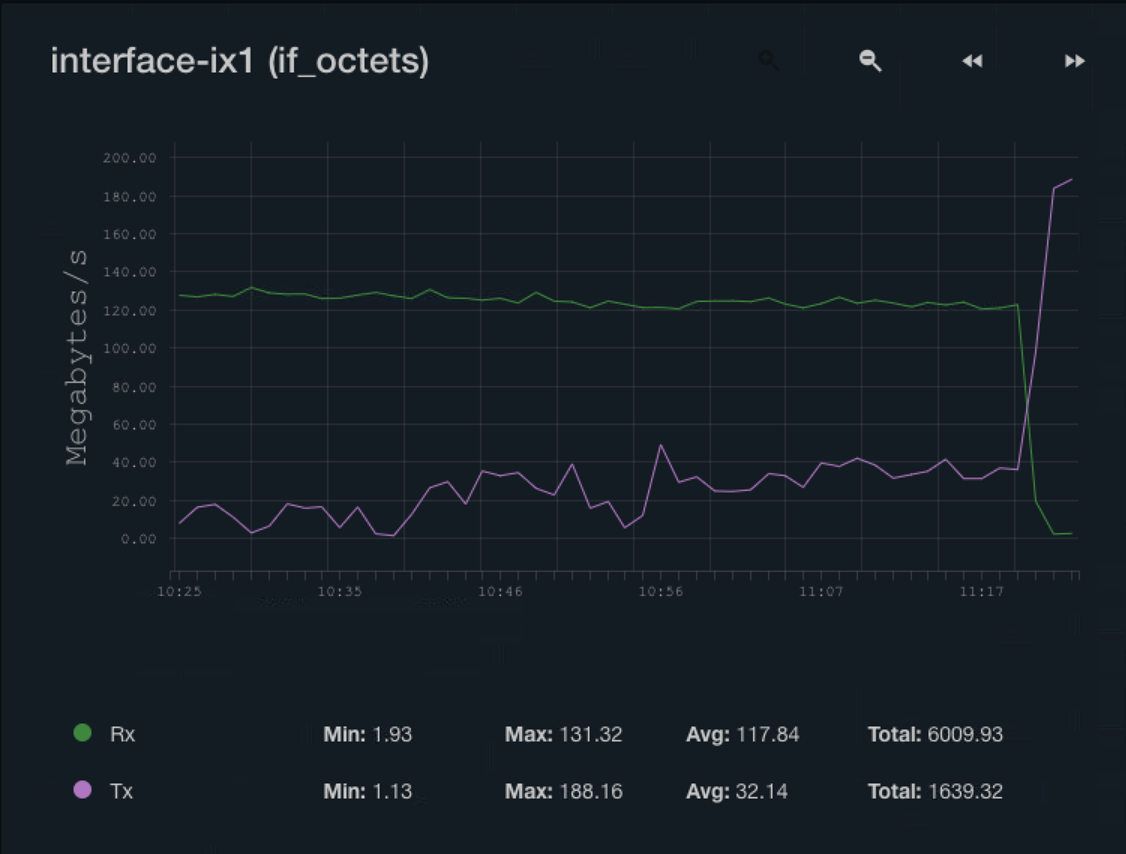

It should be easy enough to see if your network is overused by looking at network stats.
Is performance better if only a single user is editing files? Try to find the limit by increasing user counts and observing the stats change while you add more load

thanks Rand,
a user works much better, as soon as the network is used by more users the performance decreases considerably.
I have 200-300mb picci at the network card output ..
I also changed the network card from intel to chelsio .. but nothing changes, thinking that I had a defective card.
Maybe Samba who has difficulties.
I just need to try putting a 40gbe card.
I also tried to use small file prores 1080 LT, it works better. The request for each single workstation is more or less between 30-40 mb / s ... so for a maximum of 250-300mb / s total, so a 10gbe should suffice ... But as soon as everyone is editing go to hiccup.

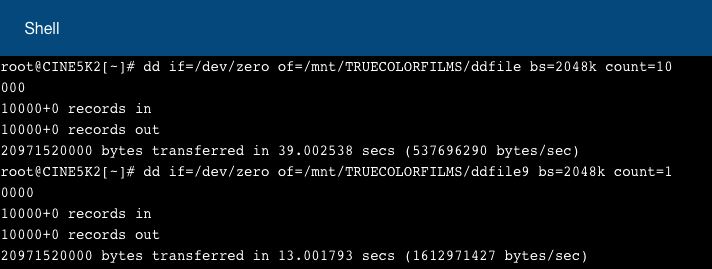

I connected a windows machine with a 10-disk 24-drive raid and connected the frennas directly with the 10gbe port, for the first 40 seconds everything works at 700mb / then dastrically drops to 200-150mb / s ... I don't understand why. I tried to raise the 64gb to 128gb ram and the only thing that changed is that the transfer time to 700mb / s from 40 seconds went to 1 minutes and 20 seconds.
Just finished, deleted the files and copied the same file, practically I have a speed of 1100gb / practically for all the time saturates the band of the network card.
So the file went into cache or something like that?
If I copy a new file it always happens the same one described above.

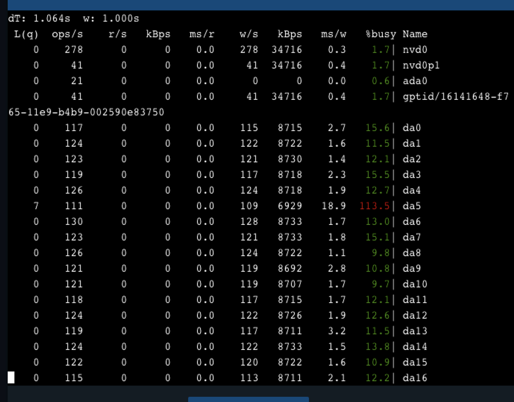

Now they are working on three workstations and gstat gives me this.

Well, the high speed that drops of is write caching in memory; thats why it took longer to drop off after you added more memory.
Then, there clearly is a drive that has issues on your pool (da5, in red) - can you replace that with a spare (or redo pool without it) to see if its bad?
