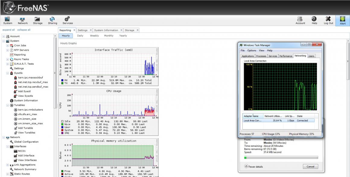

Big difference. Now I'm trying a transfer again of a large number of video files. Here is what I'm seeing:
My network throughput seems good, and my disks seem to check out now. I am copying from a USB drive, but it's a USB3.0 drive and port. Should I see better performance or is this about it? I'll try copying some over to my RAID array on my desktop then copying from there to see if the performance is better. Then I have to find out what's up with the hot swap bays...
