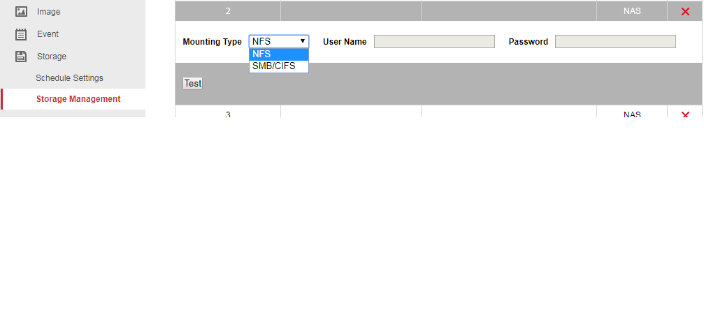

I think is SMB protocol what you mean
No these cameras have the ability to record to a NAS via NFS now there is an option to record using SMB/CIFS I don't use that option. Please read up on Hikvision cameras. They are not cheap cameras.
