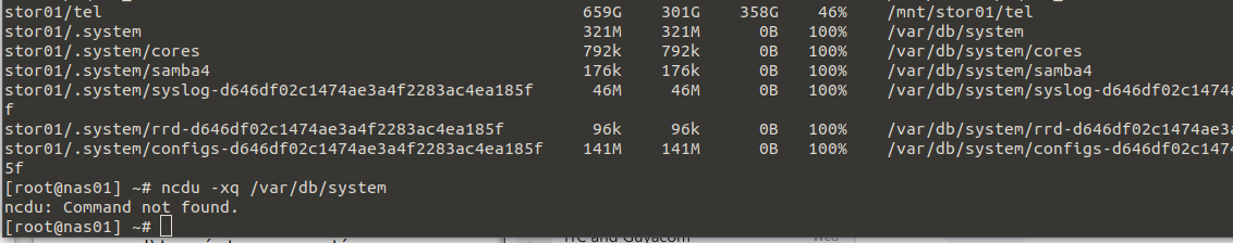

When I run df I see that there is still plenty of space for /var but I also see some .system files full and that /var/log is pointing to /var/db/system/...
Filesystem Size Used Avail Capacity Mounted on
freenas-boot/ROOT/FreeNAS-9.3-STABLE-201511040813 28G 534M 28G 2% /
devfs 1.0k 1.0k 0B 100% /dev
tmpfs 32M 5.3M 26M 17% /etc
tmpfs 4.0M 8.0k 4M 0% /mnt
tmpfs 10G 130M 10G 1% /var
stor01/.system 321M 321M 0B 100% /var/db/system
stor01/.system/cores 792k 792k 0B 100% /var/db/system/cores
stor01/.system/samba4 176k 176k 0B 100% /var/db/system/samba4
stor01/.system/syslog-d646df02c1474ae3a4f2283ac4ea185f 46M 46M 0B 100% /var/db/system/syslog-d646df02c1474ae3a4f2283ac4ea185f
stor01/.system/rrd-d646df02c1474ae3a4f2283ac4ea185f 96k 96k 0B 100% /var/db/system/rrd-d646df02c1474ae3a4f2283ac4ea185f
stor01/.system/configs-d646df02c1474ae3a4f2283ac4ea185f 141M 141M 0B 100% /var/db/system/configs-d646df02c1474ae3a4f2283ac4ea185f
I am quite newbie to freenas and I don't know where to look?

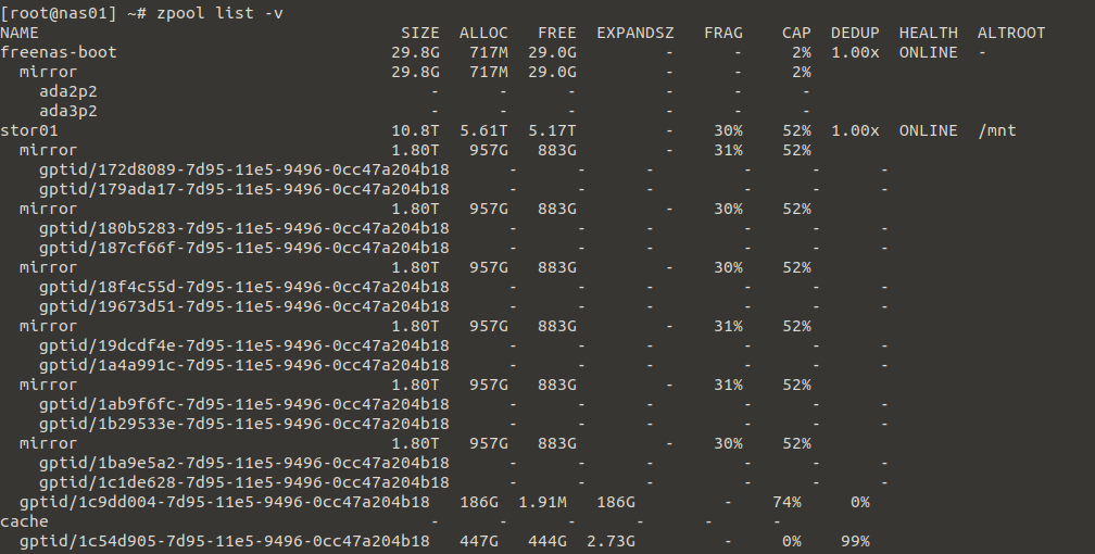

Hello and thank you for your pointers.
Here is the result of the zpool list -v
I am not sure if I am on UFS boot, it is Freenas 9.3 yes.
9,703
That just told us that you're on ZFS... freenas-boot is your boot pool.
So it must be a quota problem as you are consuming only 2% of your 29.8G and there's plenty of space on the stor01 pool where you have your system dataset.

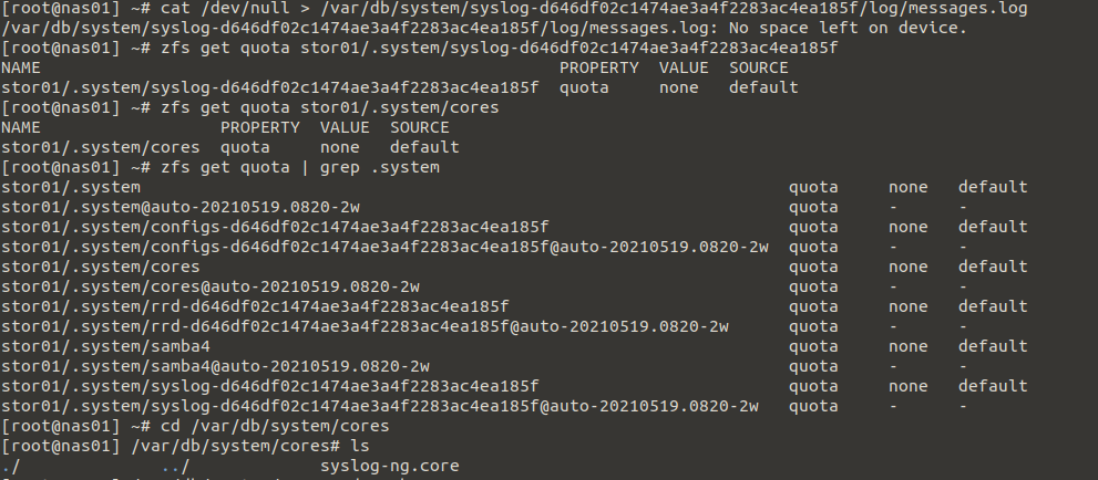

Have a look in /var/db/system/cores and see if there are large files there that can all be deleted, they are only process crash dumps.
9,703
Also, have a look at zfs get quota stor01/.system/syslog-d646df02c1474ae3a4f2283ac4ea185f and zfs get quota stor01/.system/cores
Or even zfs get quota | grep .system if the ones above provide nothing useful.
Gaspard
May 21, 2021
5
Thank you for helping out @sretalla
Here is the output of the following commands, I don't see any quota being set. Could it be a pb with the snapshot? But the snapshot should fill up the disk space (so showing up in DF).

OK, so we still haven't really found what's causing the problem yet.
Maybe try this:
ncdu -xq /var/db/system
And se if you can find a file that looks out of place there.
Gaspard
May 21, 2021
5
Maybe try this:
Hello @sretalla thanks again for your help, unfortunaltey this command is not available for this freenas version apparently.
Is it normal that the size of the stor01/.system files are small and not the siez of the /var partition?
I have rebooted the unit, I have acces to the GUI again but still some menu are not displaying and I cannot still delete anything from /var/db/system....

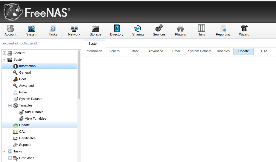

However I still not have access to all the menu in the GUI:
The update menu is not showing up, I will try to do an update via the CLI and see how it goes.
EDIT: I updated through CLI and get on 9-10 train, got the GUI fully working yeah ;-)
