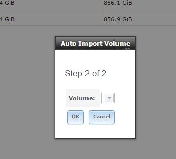

This error repeats multiple times. When I try to Auto Import the volume, it doesn't appear to see the volume. FreeNAS Volume Error-02.JPG

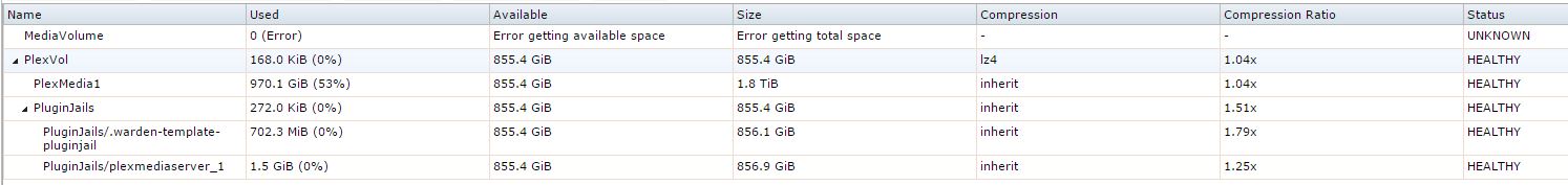

I'm looking for some advise as to how I might be able able to fix and mount the volume experiencing the issue. Other volumes appear to mount. When I view the Active Volumes, I see the following FreeNAS Volume Error-01.JPG
Jails Root: "/mnt/MediaVolume/pluginjails"
"MediaVolume" is the volume that is not mounting.

[root@freenas ~]# zpool import
f   pool: MediaVolume
  state: UNAVAIL
status: One or more devices are missing from the system.
action: The pool cannot be imported. Attach the missing
        devices and try again.
   see: http://illumos.org/msg/ZFS-8000-3C
config:
        MediaVolume                                     UNAVAIL  insufficient replicas
          raidz1-0                                      UNAVAIL  insufficient replicas
            2419691258082226199                         UNAVAIL  cannot open
            gptid/866503a4-b455-11e3-8677-002219ff710f  ONLINE
            15923671027382525871                        OFFLINE
            gptid/87b254c0-b455-11e3-8677-002219ff710f  ONLINE
[root@freenas ~]#

You had a RAIDZ1 of 4 disks. One disk failed, then another disk failed. It looks like you've got 2 disks "online", one disk is "offline" and one disk is unavailable. RAIDZ1 only protects you from a single disk failure, you have 2 disks that aren't functional at the moment, so you don't have enough redundancy.
See that part in my sig that says "RAIDZ1/RAID5 is dead". You just became another example why that is so.
You might be able to restore a disk if you forgot to connect a SATA cable or something, but that's something you'll have to figure out on your end. It sounds like you had one disk fail, then a second failed in succession before you were able to restore full redundancy. At that point, your pool would be unrecoverable. If I'm right, you need to pull up your backups and put those to use.

Well you are missing 2 drives in a raidz1 system. You need to get at least 1 drive to show up or your data in gone. You should double check your sata cable connections, check and post your drive smart data and also tell us how you replaced the drive because it looks like you didn't replace anything.
