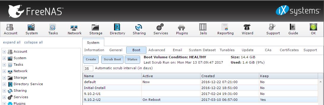

Hello,
i upgraded my FreeNAS server to the last version via the GUI, but when it reboots it doesn’t load the updated version, it keeps booting an old image. any ideas of why this happens? I've tried to reboot several times and it keeps booting the default image. I have made a scrub of the boot drive and tried to update the OS again but it just tell me to reboot.
Thanks for your help and advice.

Hi, can you activate the U1 option and see what happens?

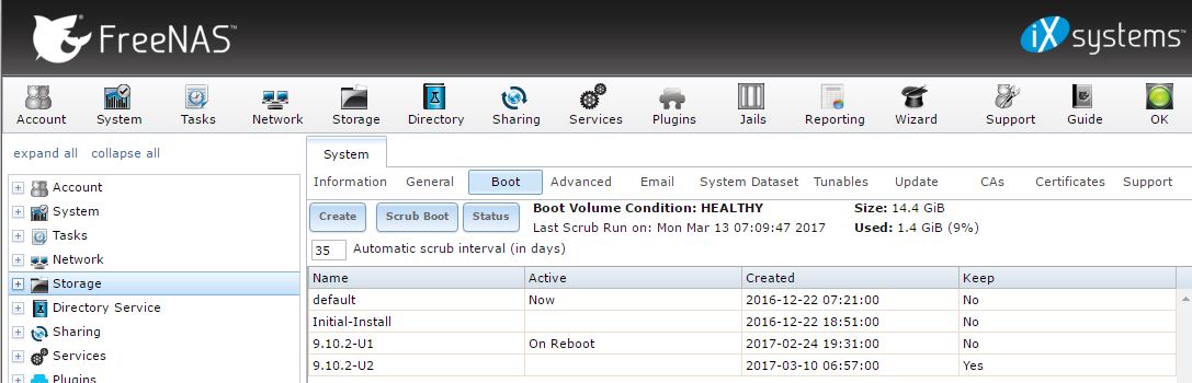

camilo suarez
Feb 28, 2014
86
No, i still get the same result.. any advice? :(

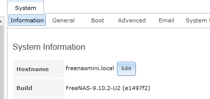

Hmmm - I don't believe those are "the same" - look at the two images and see where the indication is "On reboot" - it changes from U2 on the first to U1 on the second.
Make the trials again, but this time switch to the "System" tab and look at the "Build" line to find the active FreeNAS version reported each time.

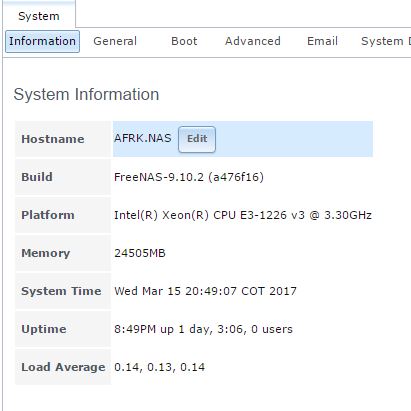

this is my version, guess is not the last one.

Redcoat
Feb 18, 2014
2,922
Hmmm.. again. I would download a fresh .iso, make a new boot stick, reinstall with that and let your data drives re-import.
