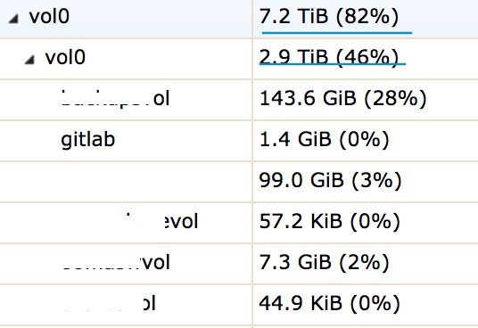

I cleaned up the disk, but...That's weird. zpool vol0 shows that it's used by 82%. Actual used space on volume vol0 is 46%
Also freenas extremely slow. zfs commands take forever, let's say change quotas, create new dataset).
I checked the scrub process on vol0 it's not running.
What's more interesting it shows 7.2T but that's raidz2 with 8 drives :D, which is actually impossible!
Any suggestions?
Thanks
