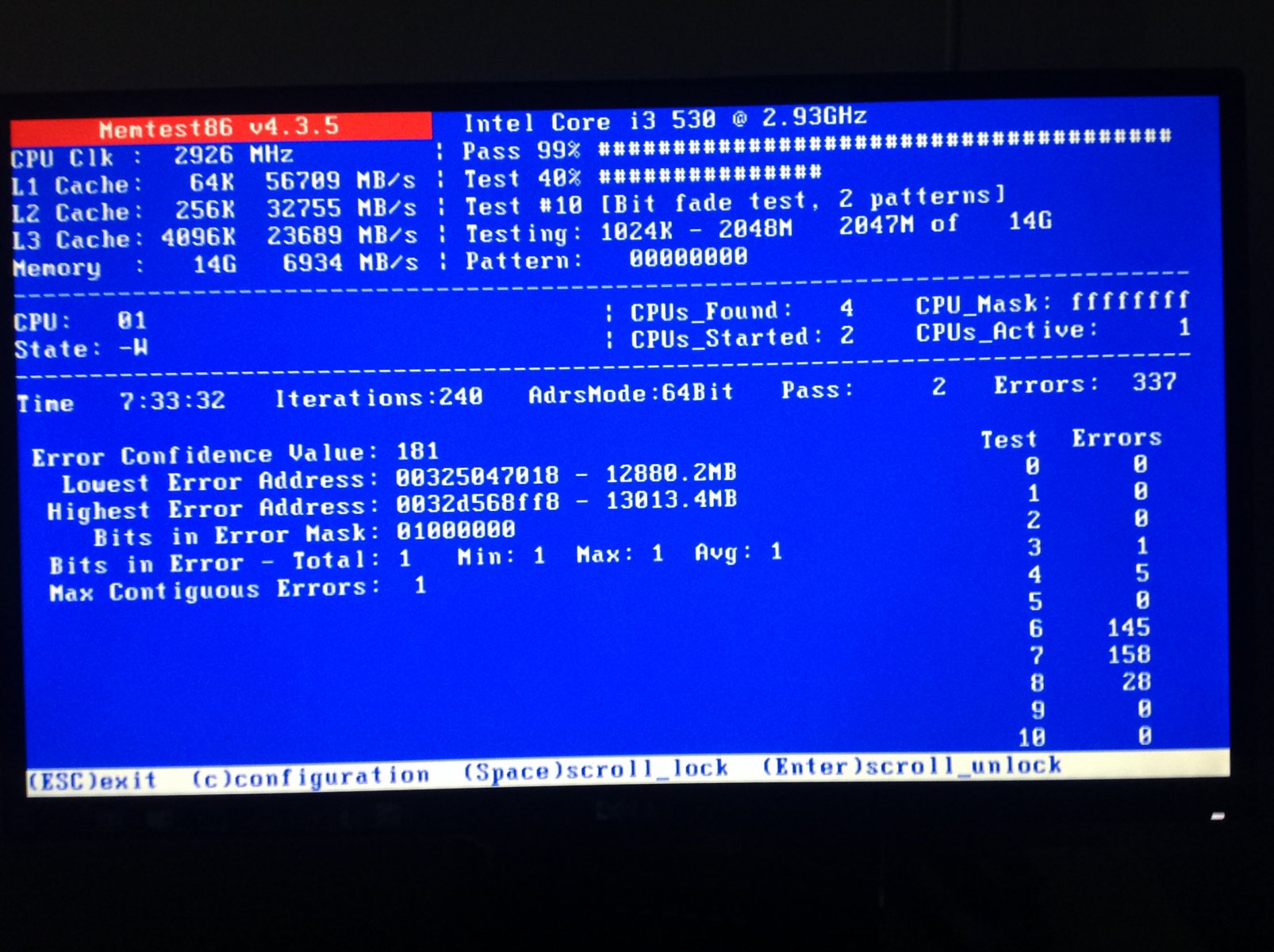

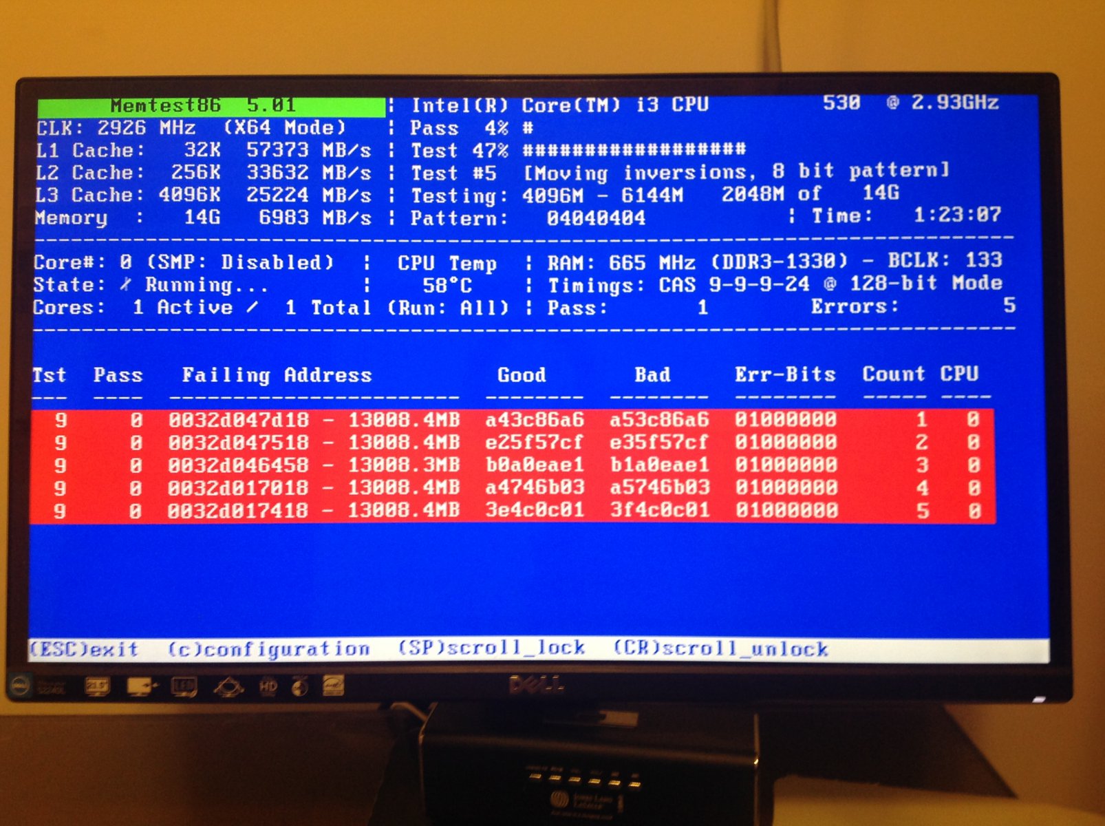

So poor N00b does have bad RAM. :(
Here is a screenshot of the test I ran with memtest86 overnight and there is one that I ran today with memtest86+ . From these screens is it possible to tell which RAM stick is bad? Or would I have to test each separately. A new stick that I bought worked fine yesterday but today is causing the box to reboot after a few seconds. Could there be another reason other than bad RAM? Help would be appreciated.
Memtest Results
Memtest86+ results

Update:
So this is what I am hoping happened. The RAM was probably ok but the 2 new sticks I added were probably incompatible with the 2 previous ones. Anyway I've traded in the old sticks for 4 new Transcend JM1333KLN 4x4GB sticks and run Memtest86+ again. Also ended up adding another 2GB to my BSD test box :).
Did 4+ passes without any error before I tripped the power supply. Currently running another 3 passes. So far so good. Now what next? :confused:

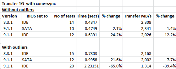

Noticed that the defaults on my mobo was loaded my disks as IDE disk and not as SATA with ACHI. Changed that to SATA and ACHI and reran tests with 9.1.1. The results are below:
The disks are set to idle so the first few writes take longer (termed "outliers"). Also reran Lantest (lite) : Here are the results:
Version 9.1.1 drives read as IDE.
Test File: Z:\homes\user\tmp-retest\NW_SpeedTest.dat Write Time = 0.2411796 Seconds Write Speed = 663.4059280 Mbps Read Time = 0.1935905 Seconds Read Speed = 826.4866960 Mbps Test File: Z:\homes\user\tmp-retest\NW_SpeedTest.dat Write Time = 12.6212540 Seconds Write Speed = 649.0638720 Mbps Read Time = 9.2783818 Seconds Read Speed = 882.9125760 Mbps
Version 9.1.1 Drives read as SATA
Test File: Z:\homes\user\NW_SpeedTest.dat Write Time = 0.2432111 Seconds Write Speed = 657.8646880 Mbps Read Time = 0.1889158 Seconds Read Speed = 846.9379680 Mbps Test File: Z:\homes\user\NW_SpeedTest.dat Write Time = 11.9194912 Seconds Write Speed = 687.2776560 Mbps Read Time = 9.9129474 Seconds Read Speed = 826.3939760 Mbps

We're really in uncharted waters here because nobody has had a mountable pool after bad RAM. If you have files that were sourced from someplace else and then copied to your server it would be interesting to see of their MD5s changed. It's probably impossible to really know how bad/good your data is, but you are very lucky as you are the first to not lose their entire pool. Of course, you may find a lot of bad files in the future and not be too thrilled with that. But only time will tell.
N00b
May 31, 2013
83
CJ, here are two sample logs of the scrub process.
First Scrub
  pool: rock
 state: ONLINE
    corruption.  Applications may be affected.
action: Restore the file in question if possible.  Otherwise restore the
    entire pool from backup.
   see: http://www.sun.com/msg/ZFS-8000-8A
  scan: scrub in progress since Sun Nov  3 06:38:19 2013
        841G scanned out of 6.99T at 309M/s, 5h48m to go
        0 repaired, 11.75% done
config:
    rock                                            ONLINE       0     0     0
      raidz1-0                                      ONLINE       0     0     0
        gptid/61144d95-836b-11e2-8960-001aa0e32c82  ONLINE       0     0     0
        gptid/6204197b-836b-11e2-8960-001aa0e32c82  ONLINE       0     0     0
        gptid/62b13961-836b-11e2-8960-001aa0e32c82  ONLINE       0     0     0
        rock:<0x49a09>
        <0x6485>:<0x49a09>
        <0x6485>:<0x499df>
2nd Scrub
  pool: rock
 state: ONLINE
  scan: scrub repaired 0 in 5h19m with 0 errors on Sun Nov  3 13:19:14 2013
config:
    rock                                            ONLINE       0     0     0
errors: No known data errors
Let me figure out how to run MD5 on a lot of files as most of the me are scattered over multiple directories and machines (ie. on home pc , work laptop etc). They are all in one directroy on the nas. It wouldn't help to run Md5 on just a few files would it?
cyberjock
Inactive Account
Mar 25, 2012
19,525
It's actually really complex. If the data was correct in RAM but the parity is trashed then I think a scrub will fix it. But if the data was corrupted in RAM then it's just trashed. There is no fixing it because ZFS doesn't know any better.
As for doing MD5 comparison you can just do md5sum * and get a list of sums for directories. But even if they match you have to consider things such as where the other non-server copy came from. If they came from the server originally they can be corrupted too since they have the same source and the md5sums will match giving the false impression they aren't corrupt. If you did rsync they could be corrupted for the same reason. To add to the confusion, if your RAM went bad just a day or two before and if you hadn't run a scrub or an rsync/zfs replication to your backup server since the RAM went bad then only your newest data has a chance to be corrupt.
So its one of those things where you can only make these two solid conclusions:
1. If the files from your server and the backup match the files may still be corrupt.
2. If the files from your server and backup don't match then at least one of them is corrupt. (Probably only 1 but there's no way to have a reasonable assuredness of this).
Notice I didn't provide a way to prove the files aren't corrupt. That will depend heavily on when and how you do backups and when your RAM went bad along with some random dumb luck. Since you don't really have much control of the those 3 things or their relationships its darn near impossible to be 100% sure(or even reasonably sure) of anything. :(
But if you have some "newer" files that total large quantities of disk space that might be an interesting comparison. Preferably a total number of bytes exceeding 5x your RAM to increase the likelyhood of the bad RAM being allocated.
You are welcome to do the md5sum(and it goes pretty fast from the CLI) but you really won't prove that files aren't corrupt but you might prove that some are. :p
If you are actually interested in trying this out I can help you via teamviewer. Just PM me with a skype name or some way to chat with you and I can help you test it out. I'm somewhat curious to see what the results are, but its more of a curiosity than a way to prove your files are safe from corruption.
