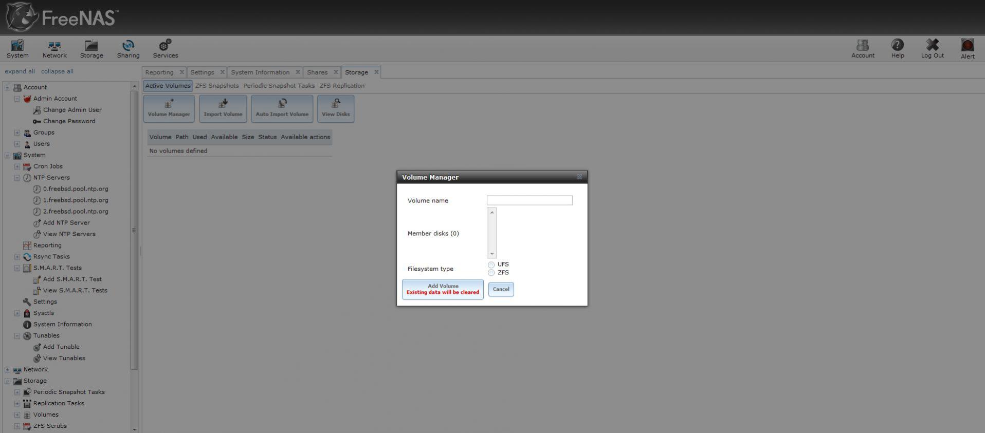

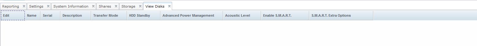

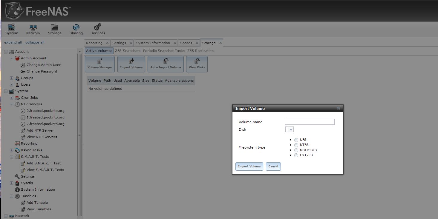

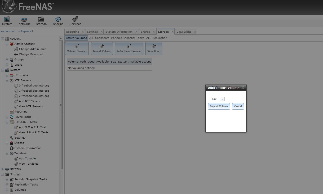

Hi All,
I am a FreeNAS newbie.
I have installed FreeNAS 8.2 in Dell Optiplex 330 PC successfully but i cannot see HDD in web GUI (see the attached) picture. I think I may miss some setting but not sure.
Do you have any idea?

Here's your possibilities that I can think of:
1. Hard drive doesn't have power, or otherwise isn't plugged into the motherboard.
2. The hard drive controller on the motherboard(assuming you are using the built-in controller) is not compatible with FreeNAS.
3. Hardware failure of the hard drive itself.
4. Data cable for the hard drive failed.
cyberjock
Inactive Account
Mar 25, 2012
19,525
I googled your computer. It has an ICH7R chip. Are the hard drives in a RAID or is the controller already configured for RAID mode? If so you should change it to IDE, AHCI, or whatever the non-RAID mode is and try that.
monnakrub
Jul 29, 2012
3
In shell mode, I can see my harddisk
<ST3160815AS.ADA> at scbus1 target 0 lun 0 (pass0, ada0) >>>>> my harddisk
<TSSTcrop DVD+-RW TS-H653B D300> at scbus2 target 0 lun 0 (pass1, cd0)
