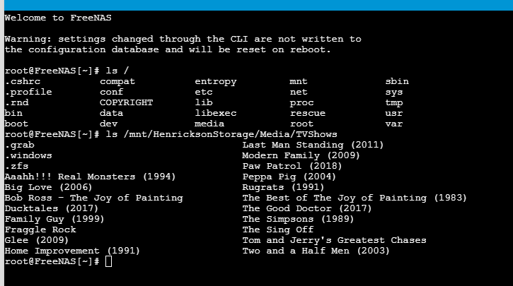

Can you please show the output from ls -l /mnt/HenriskconStorage/Media/TVShows
and
getfacl /mnt/HenriskconStorage/Media/TVShows

root@FreeNAS[~]# ls -l /mnt/HenriskconStorage/Media/TVShows
ls: /mnt/HenriskconStorage/Media/TVShows: No such file or directory
root@FreeNAS[~]# ls -l /mnt/HenricksonStorage/Media/TVShows
total 173
drwxrwxrwx+ 2 root wheel 2 Apr 13 03:03 .grab
-rwxrwxrwx+ 1 root wheel 0 Mar 10 23:53 .windows
dr-xr-xr-x+ 3 root wheel 3 Oct 24 2019 .zfs
drwxrwx---+ 6 root wheel 6 Oct 24 2019 Aaahh!!! Real Monsters (1994)
drwxrwx---+ 5 root wheel 5 Oct 24 2019 Big Love (2006)
drwxrwx---+ 28 root wheel 28 Oct 24 2019 Bob Ross - The Joy of Painting
drwxrwx---+ 3 root wheel 3 Oct 24 2019 Ducktales (2017)
drwxrwx---+ 4 root wheel 4 Dec 1 22:00 Family Guy (1999)
drwxrwx---+ 4 root wheel 4 Oct 24 2019 Fraggle Rock
drwxrwx---+ 6 root wheel 6 Oct 24 2019 Glee (2009)
drwxrwx---+ 10 root wheel 10 Nov 3 15:20 Home Improvement (1991)
drwxrwx---+ 4 root wheel 4 Jan 2 21:00 Last Man Standing (2011)
drwxrwx---+ 5 root wheel 5 Oct 24 2019 Modern Family (2009)
drwxrwx---+ 2 root wheel 3 Jan 11 22:21 Paw Patrol (2018)
drwxrwx---+ 6 root wheel 6 Jan 13 23:43 Peppa Pig (2004)
drwxrwx---+ 5 root wheel 5 Nov 3 21:37 Rugrats (1991)
drwxrwx---+ 8 root wheel 8 Nov 12 07:00 The Best of The Joy of Painting (1983)
and now
root@FreeNAS[~]#
root@FreeNAS[~]# getfacl /mnt/HenricksonStorage/Media/TVShows
# file: /mnt/HenricksonStorage/Media/TVShows
# owner: root
# group: wheel
owner@:rwxpDdaARWcCos:fd-----:allow
group@:rwxpDdaARWcCos:fd-----:allow
everyone@:r

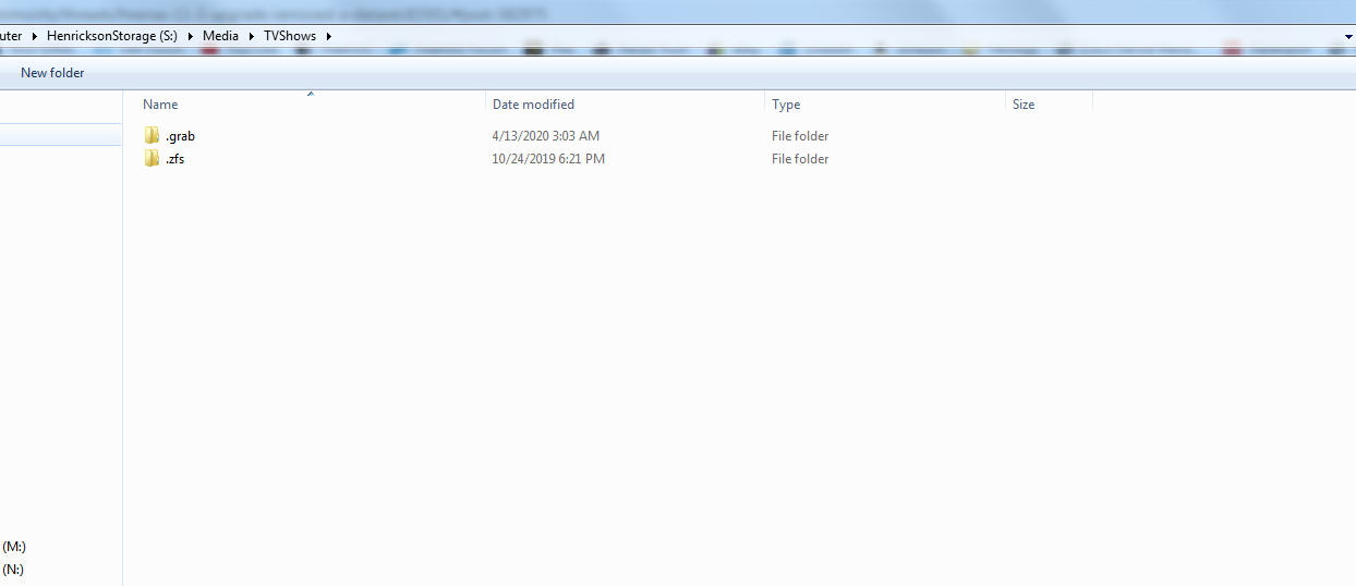

The permissions are as you say all for root:wheel (unix) permissions.

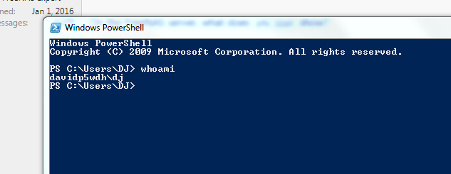

In Windows, under a powershell window, what do you get from whoami (or have you specified the user in the drive mapping for s: )?

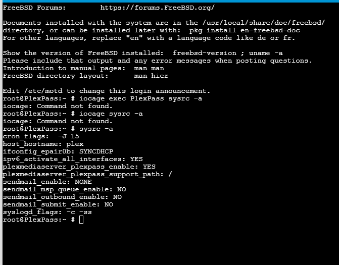

Also, in the jail what do you get from running sysrc -a (iocage exec plex sysrc -a ... substitute plex for the name of your plex jail to run it from the host)

On Windows, I map the drive as a "another user' and use the Root user with the primary password. This should give the system full and unlimited access this way and bypass user setup and permissions and whatnot, right?

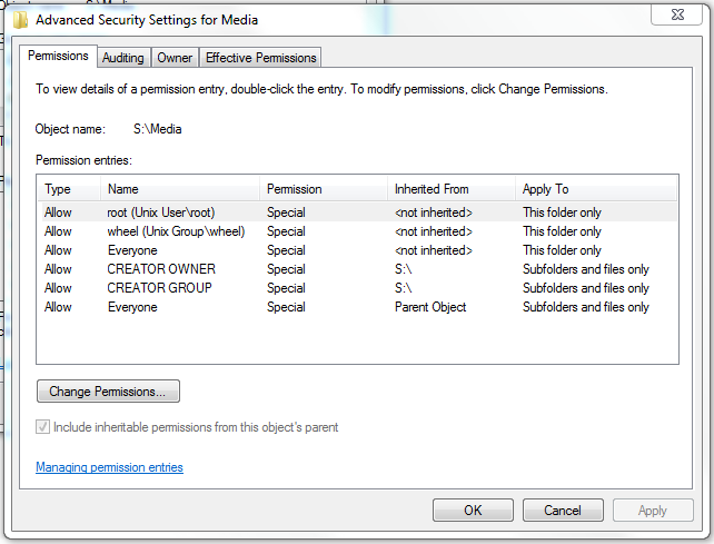

All the permissions are looking right/OK.
I'm guessing that you're set up on the share to use ACLs although none are defined...
Maybe as a test we should add an ACL entry on the share with "everyone" giving full permissions, just to prove that it's a permissions problem.

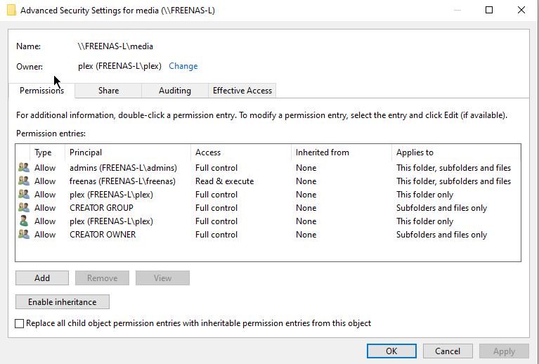

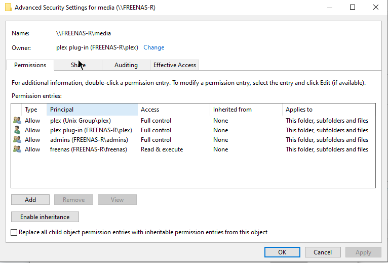

Then Add ACL Item (button in the middle on the left).
Then on the right, edit the Who to be everyone@
Then change the permissions to Type, Basic and Full control.
Tick the Apply permissions recursively and save.
And be sure to select Inherit! I've had no-access issues despite all permissions set correctly, once I selected Inherit, everything worked as expected.
David Henrickson
Jul 26, 2017
93
Hello @sretalla , I have done that. It still just does not show up for me to view. Copy elsewhere. View. Anything. So......strange and depressing.
