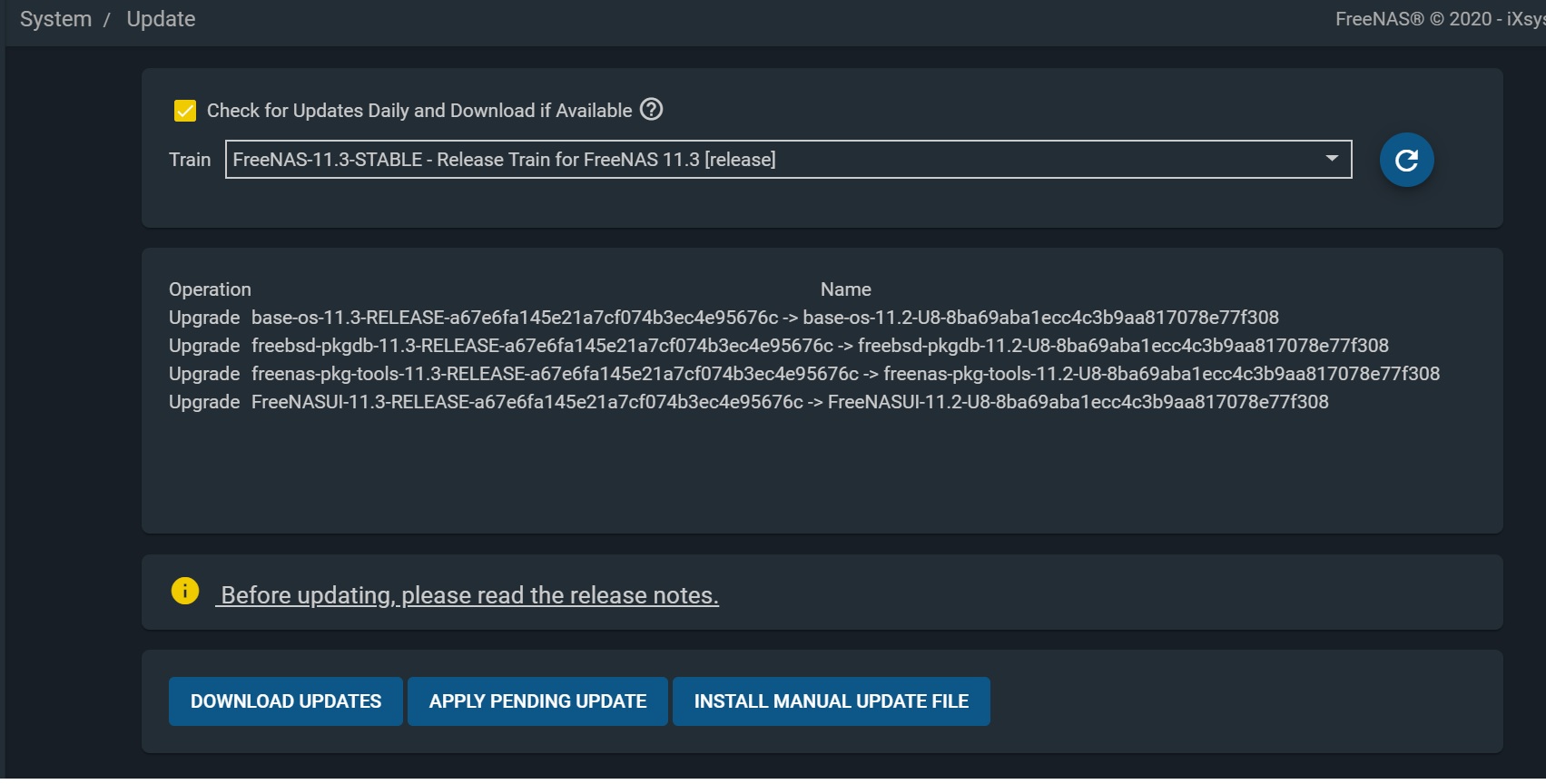

I had lots of permission issues with my FreeNAS 11.2-U7. I have performed a fresh install of 11.3 release. I did however upload the config from 11.2-U7 after successfully installing the new release.
Now, however, I get an 'upgrade available' notification to upgrade from 11.3 to 11.2-U8. See attached
Is there any way to fix that?
Thanks,
Gary

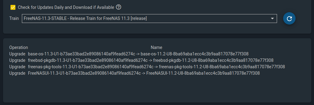

Try midclt call update.set_train FreeNAS-11.3-STABLE
khr
Feb 27, 2020
Had the same issue after an upgrade to 11.3_U1 via USB - performed the command above - issue solved - thanks Patrick!

Unfortunately, I did confirm the "downgrade" from 11.3-U1 to 11.2-U8 when seeing the alert about a new update. After the reboot, the system hangs at "middlewared: setting up plugins (alert)" but could be recovered by selecting the previous boot environment 11.3-U1.
The suggestion by @Patrick M. Hausen solved the misleading update alert. Thanks!

I have gone through the same 'issue', where the updates are downgrades....
I went through the update process, but system would not boot, so re-installed 11.3, and system is running fine --- thankfully, the code as listed above cleared up the mess, and the updates page shows No updates available ... Thank you Patrick !
