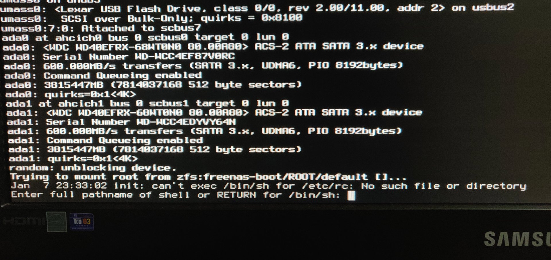

Hi Gurus,
I have installed freenas 11.2.u7 and some time it Boot properly and displays the IP address but many time it does not completely bootup and stands on the error. Please see attached picture and advise what could be the reason for this error and how can I fix this.
Thanks

I'm going to guess you have a bad/corrupt usb boot drive. This is the most common reason for this kind of issue.
More info about your hardware would likely assist in providing better help.

Are you using a USB stick for boot drive? If so, have you made and used a new one with a good quality USB key? Is it in a USB 2 or USB 3 slot? USB 2 slots are reported to be less error prone.

I have actually installed freenas 11.2.U7 on a new USB pen drive and its USB 2. USB 3 does not work for me. On the new installation I have imported my existing Pool and then re-installed Plex Server Plug-in and created my window share and all required setup for Plex. It was working fine. I just thought I should restart the server and on the restart its not booting up properly. I do not have my saved script. Now only way left for me to do the whole excercise again and re-install freenas 11.2 or latest on a totally new usb drive and import my pool again and re-install my plug-ins.

Sounds like you have the right idea. Be sure to use a good quality usb stick. If you have a spare SATA port, consider getting a small ssd, maybe even a used one from ebay - e.g. 40GB Intel ssd's for US$15-$20 - and move away from the (high) potential pain associated with USB sticks.
