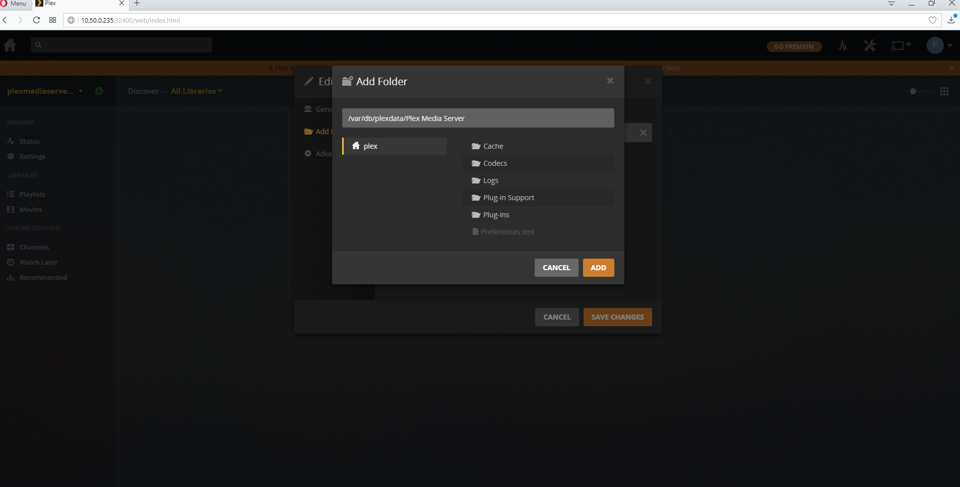

This is the first time I have tried to use Plex as a Jail on FreeNAS 11.1-U2.
Everything was going fine until I got to the part where I started to "Add Folders" in Plex. I am not seeing the root folder (/). Even if I manually type out the path it doesn't see it. By default, when I open "Add Folder" in Plex I'm brought to /var/db/plexdata/Plex Media Server.

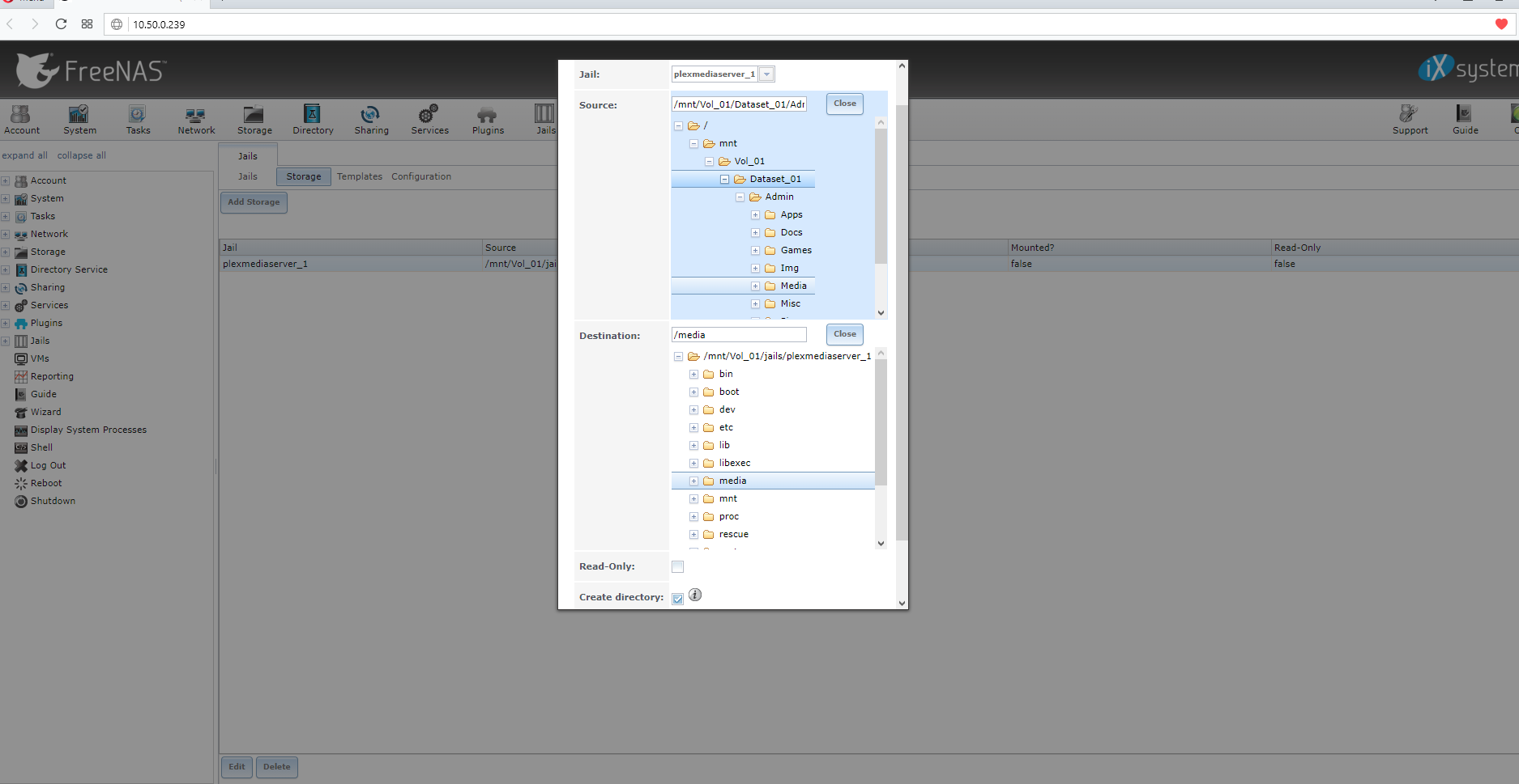

Here's a screenshot of the source and destination setup.
9,703
One note and a suggestion:
I note that your definition inside the jail is in all lower case, while the dir on the host FreeNAS starts with a cap (i.e. Media --> media)
Have you had a look inside the jail at the permissions on that directory?
jls to find the number of the jail, then jexec <number> csh to get a command prompt in the jail, then use ls -l in the jail filesystem to find the permissions and for which user.
If you see numbers instead of usernames, that's a guarantee to show that you haven't got your plex user aligned in the Jail and FreeNAS to have permission over the files.
A really non-secure way to fix it without going into the issues of user setup would be chmod -R 777 /media
Otherwise, there are a few articles you should be able to find describing user and permissions setup in a jail.
