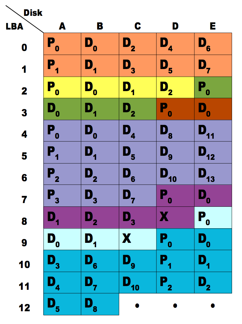

That's not how RAIDZ2 works. RAID-Z distributes parity across multiple drives, so you can't "choose" which drive is parity. Further, part of the file system's guarantee is that every byte of data will survive if you remove up to two drives.
Currently I'm running Raidz2 , but going to RMA two drives, can I have my other two working drives be the main drives and the new RMA drives become parity drives?
How do I ensure my data is on my two working drives before sending out the failed drives?
That is not how RAIDZ works. That's not how any self-respecting RAID solution works. Yes, that means unraid is a piece of crap, it's not an accident of language. I'll take HW RAID over unraid any day of the week, which says a lot.
The illustration below, helpfully supplied by Matt Ahrens in his blog at Delphix, shows how data is distributed among disks in a RAIDZ vdev. P is a parity block, D is a data block and X is a padding block to meet certain requirements that are irrelevant to the current discussion. All disks get both parity and data.
The illustration below, helpfully supplied by Matt Ahrens in his blog at Delphix, shows how data is distributed among disks in a RAIDZ vdev. P is a parity block, D is a data block and X is a padding block to meet certain requirements that are irrelevant to the current discussion.All disks get both parity and data.
Thanks for correcting me!
"All disks get both parity and data." That's key feature.
