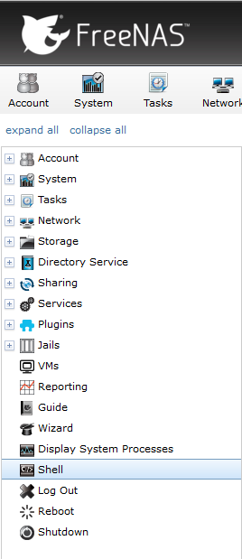

Also, if the developers of FreeNAS meant for you to NEVER use the command line, they would have disabled SSH, and not given us a very convenient little icon called Shell.
So, please don`t mislead people by telling them using the command line is wrong.
