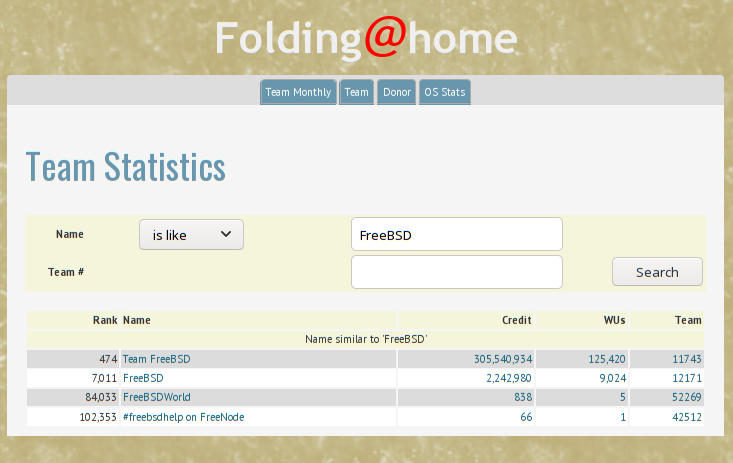

/usr/local/etc/fahclient/config.xml file if you'd like to contribute as a member of folding team FreeBSD, by adding line <team v='11743'/>PS. Due to this being Linux software that has not been modified to function entirely as FreeBSD, the below adjustments to your /etc/fstab may be necessary.
