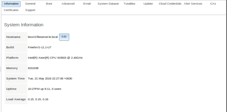

After updating freenas shared folder is not working in Ubuntu 16.04 and lower versions. In windows 7 & Windows 10 it is working.

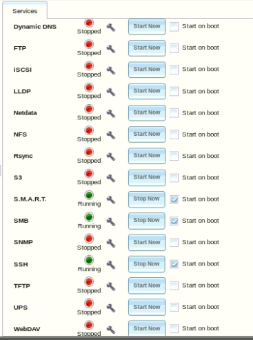

Thank you. SMB is Checked, there is noting called SMB1. Please find the attachment for your reference.
slkamath
Sep 15, 2018
14

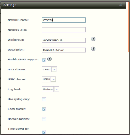

Click the wrench next to "SMB". This brings up the SMB configuration form, which will allow you to check the box.
Thank you so much.
It is working now.
