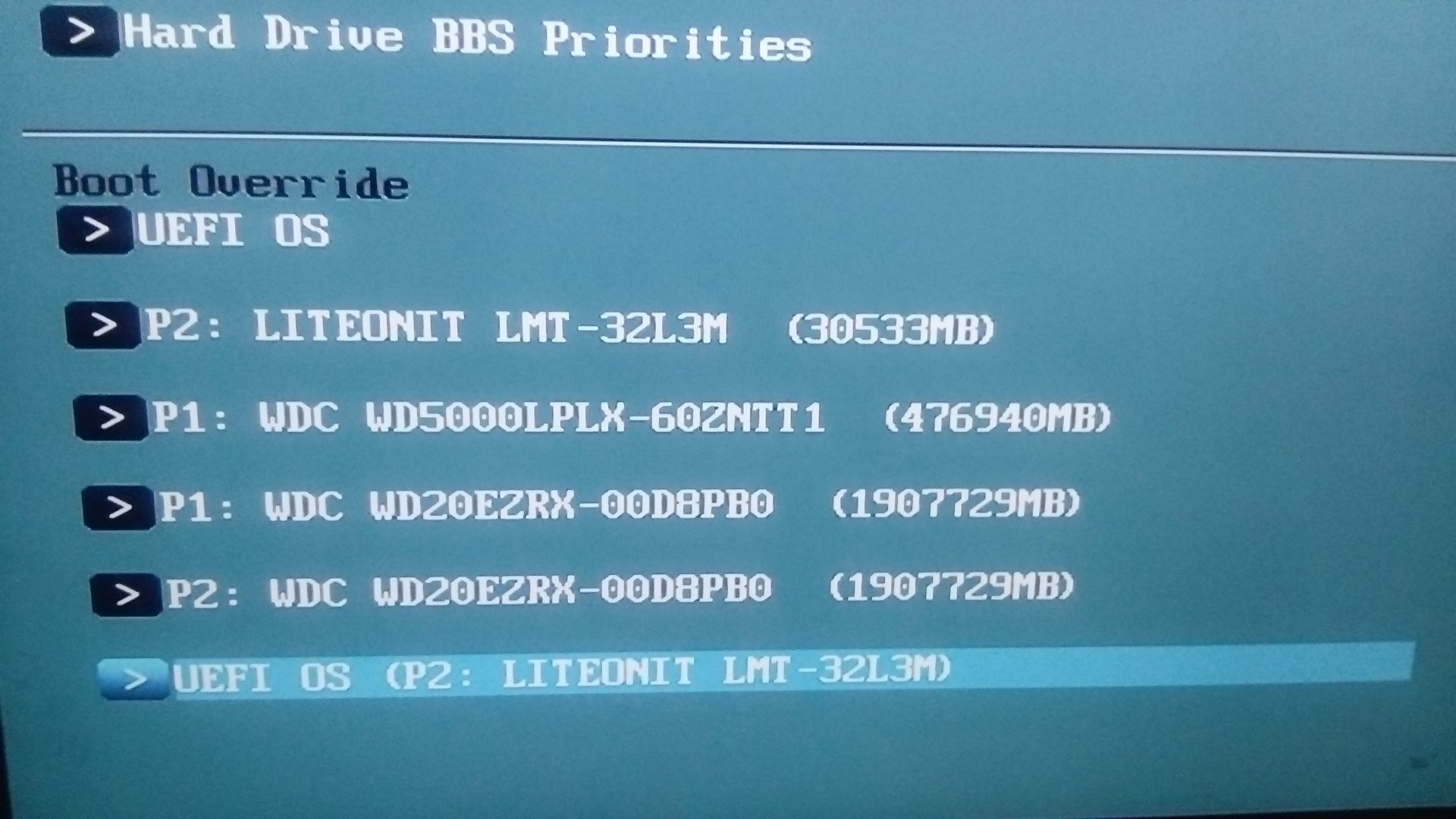

it depends weather you installed the using bios or UEFI.
i have recently installed freenas but when i reboot got the same message you had got so i went in the bios and to boot order and noticed UEFI OS so i selected that.
