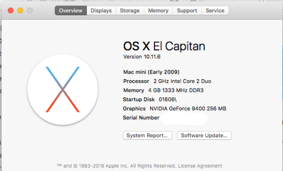

My test results: Mac and Windows client duplicate speeds of large and small files in an SMB share.
Notes:
  1. I'm not familiar enough with the Mac OS to do the macOS Shell SMB or Finder NFS test, so these have been omitted from the table.
  2. Clients and server coexist on a 1Gb/s network.
  3. Parameters have not been tuned on datasets and shares.
  4. Tests were done against approximately 18 GB each of large files and small files.
  5. A low specced Mac was all I had to do the comparison with (see attachment). It's possible the OS X performance figures would have been better had I used a more current and better specced machine.
