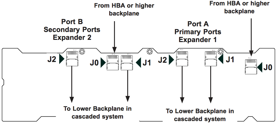

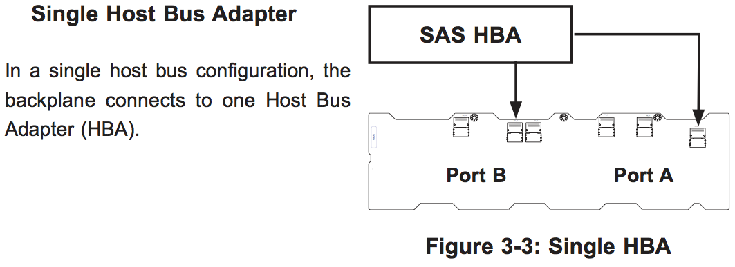

Thanks marbus90 - I have SFF-8087 cables on my list for the order. Thanks for calling it out. The case does have an expander with 6 SFF-8087 ports. The reverse breakout cables I've seen all have 4 sata connectors. I was assuming I'd need one per 4 drives or 2 given my current need. I have this SAS expander: BPN-SAS2-836EL2. My assumption was that I'd flash the LSI 2308 into IT mode, plug the sata connectors into the 8 ports and then the SFF-8087 into the correct SFF-8087 port on the expander. Of course, I need to figure out, by digging into the manual, which of the 6 SFF-8087 ports that would be. Is that correct?

Yes, but you can only use 1 or at most 2 8087 ports. From what I understand, even the old expanders support 2x 8087 uplinks to the board. But you need only to connect PRI_J0 from the (rear view) right-hand side expander to run all 16 bays on SATA. The left expander is useless without SAS disks.

So my LSI 2308 would be my Host Bus Adapter (HBA). I would have two SFF-8087 reverse breakout cables, each connecting 4 of the 8 sata ports, the SFF-8087 would plug into each of the J0's on the expander? Or, do I just need one SFF-8087 plugged in and somehow the expander sees the other 4 ports not attached to the breakout cable because it sees the LSI 2308 as the HBA (my logical mind makes me think all 8 need to be connected to work).

If I do fill both Jo's with SFF-8087, how do I expand to another 8 drives in the future? Sorry for all the questions, just when you think you have it figured out.....

Only the primary expander on the right of that picture is neccessary with SATA disks. Connect J0 of the primary expander to the HBA and all 16 disks can be used with that single connector cable. The expander multiplexes all 16 disks onto that single SAS cable. No, it won't be a slowdown, you can still use ~130MB/s per bay. That's in the ballpark of HDD speed.
