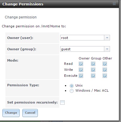

I can copy files from any pc to this volume (from PC disk to freenas volume) but one it is on the Freenas - it becomes read only file and I cannot update it any more.

Any way I think that I have set the permissions correctly as it was working in the last 18 months.
The wiered fact is that you can save the file for the first time (new file) and then it becomes a read only file...

yes have checked it.
I have attached the "change permissions" windows, so you can see what I mean, might be that I have a mistake ?

that's the same as mine - except i have the owner as guest

try deselecting a box, then reselecting and then hit the change button - this may re-register your permissions

Looks like re-selecting the permissions did the trick. All new files stored in the NAS can be updated.
Some files are still "read only" ones - but it can be managed.
