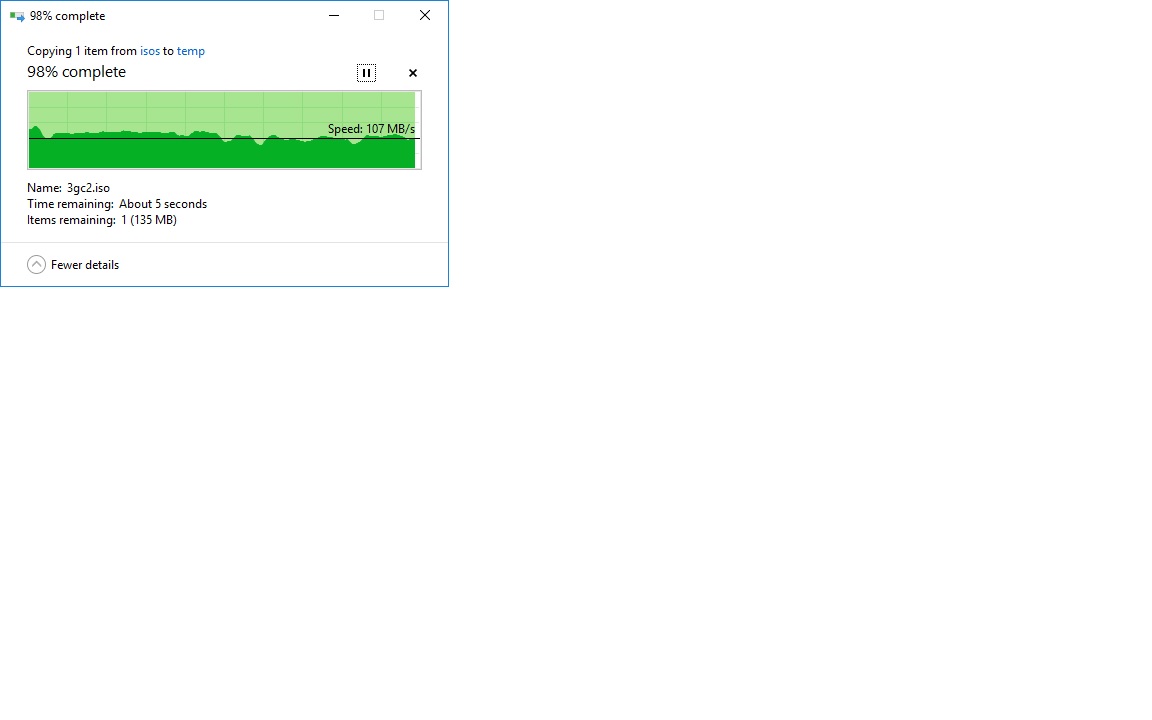

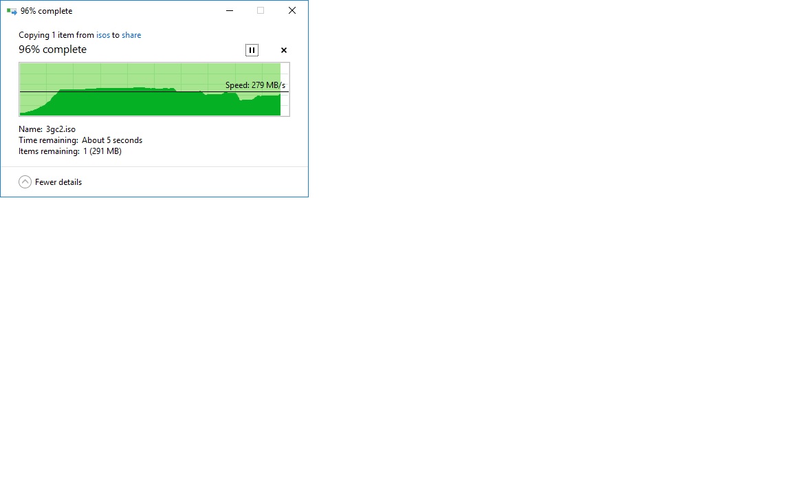

I'm running freenas under exsi 6.7 and this is for home use.
I've recently upgraded to 10gbe network using a mikrotik switch and Intel x520 da2 nics.
When I transfer from PC to Freenas I get speeds close to 500MB/s at the beginning but then this drops to 100MB/s and remains until completion.
I don't think it's a network issue as I transfer to another Windows VM and I get a constant 300-400MB/s.

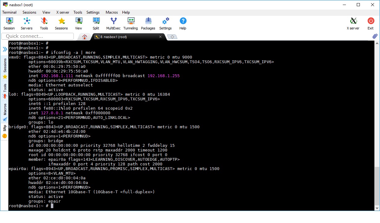

ifconfig output on pfsense.

What are the IP addresses of all the hosts involved, and do you have different IP networks? If yes on the latter, is pfsense doing the routing between the networks? That can cause a serious problem. You best bet is it to use iperf/iperf2 to test network throughput without involving storage. That way you can validate the network performance without an extraneous factors. Also, what version of FreeNAS, and please tell us about the exact CPU model and how many cores are assigned to the FreeNAS VM.

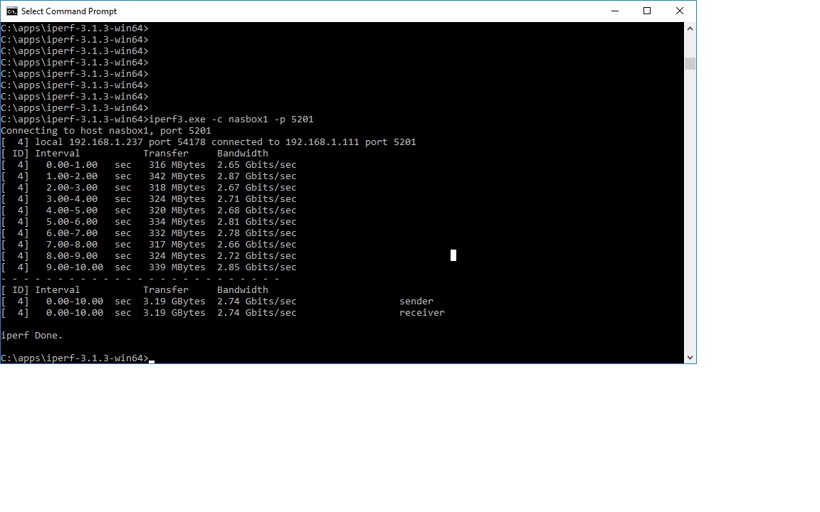

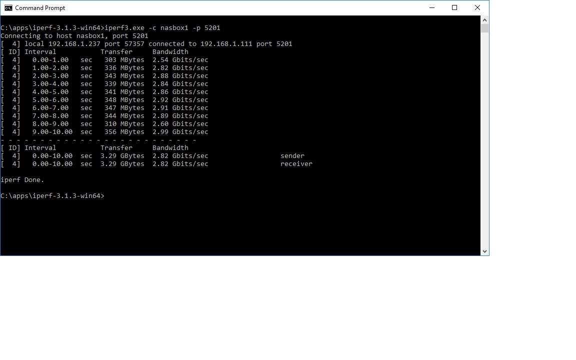

I've done some iperf3 tests from.
Windows machine to Windows VM on esxi server.
Something seems wrong as I can transfer with high speed but iperf3 is showing lower speeds. Or am I reading this wrong?
I'm using iperf3 for windows.

Dec 29, 2014
1,135
Do you have vmware tools of some sort installed? I probably need to defer to others who are more knowledgeable on virtualizating FreeNAS. There are quite a few threads on this if you search the forums. Both my FreeNAS systems are bare metal.
Dec 29, 2014
1,135
Really appreciate you help by the way.
You are welcome.
That is odd because normally it is the other way around. iperf is testing with synthetic traffic so you don't have any dependencies on storage that could slow your results. It is only testing the network stack and underlying network. I am just guessing here, but it could be that since SMB/?CIFS transfer are not normally done with synch on, the writes could be getting buffered giving you higher speeds. That is just a guess, and not what I would normally expect to see.
