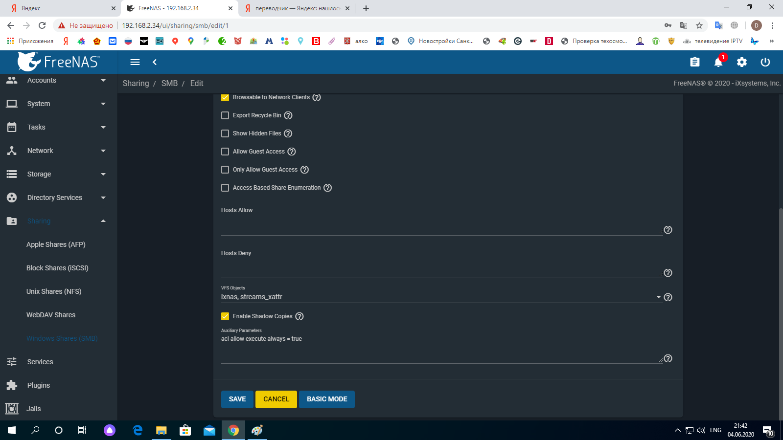

Have you tried adding this to the Auxiliary Parameters of the share definition?
acl allow execute always = true

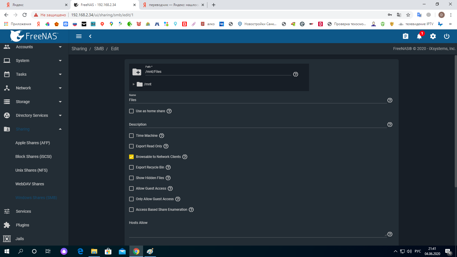

Samuel Tai
Apr 24, 2020
5,399
Do I need to add this to Global service SMB?
No, select the share in Sharing->Windows Shares. Under the check box for Enable Shadow Copies, is the entry field for Auxiliary Parameters. After adding the parameter, restart SMB.

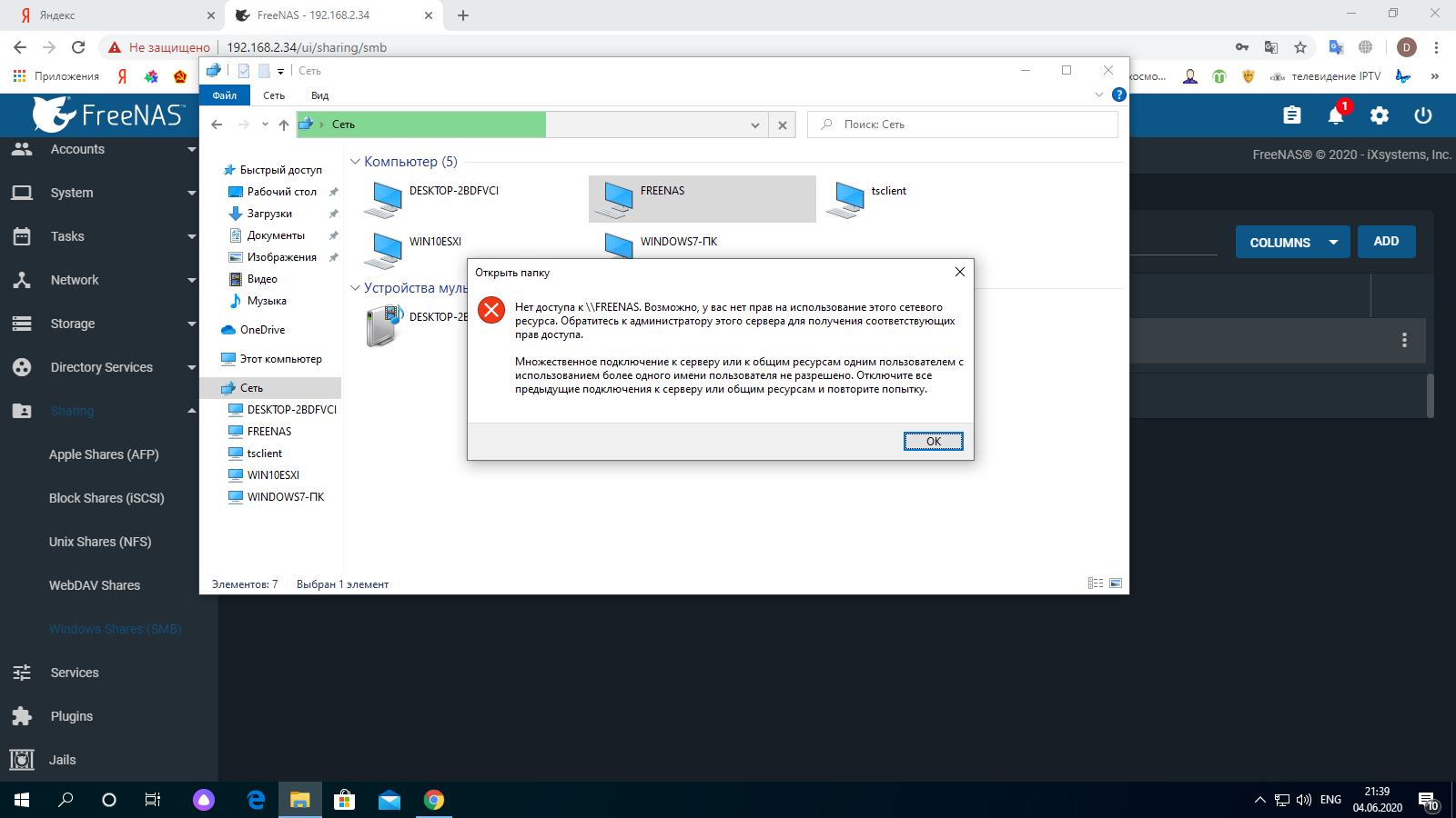

After I added the auxiliary parameters, there is no access. Even when I remove the auxiliary parameters, there is still no access now. What am I doing wrong?

Samuel Tai
Apr 24, 2020
5,399
Did you restart SMB under Services->SMB after making the change?
