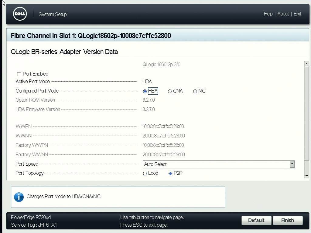

I followed all the steps on FreeNAS-11.3-RC2 for my QLogic Brocade 1860-2 QLE 2662 cards but can't tell if it's recognizing them or not. What's the best way to tell?
I see a bunch of these in dmesg. Does this mean they're unsupported?
pci18: <serial bus, Fibre Channel> at device 0.0 (no driver attached)
pci18: <serial bus, Fibre Channel> at device 0.1 (no driver attached)

It is hard to say anything without more detailed information, for example, `pciconf -lvcb` output. 26xx series is not the latest, so I would be surprised if there were new models.
Also, according to datasteet I see, those adapters are mixed FC/Ethernet. Have you checked that they are in FC mode, and the devices you see are not FCoE, which is not supported?

Before I wiped the CentOS install for FreeNAS, I went in and set them all to FC. Here's a sample of the output.

I am afraid this HBA is not compatible. It is not a native QLogic HBA, but Brocade, whom QLogic just bought at some point. It requires different driver that we do not have and probably won't since the line seem to be discontinued after that generation.

It turns out this card, while still a brocade, is used as a QLE2662 under HP and Dell but I can't flash the cards with the firmware from them. Know of any way I can force flash a card with the firmware to try it out?
