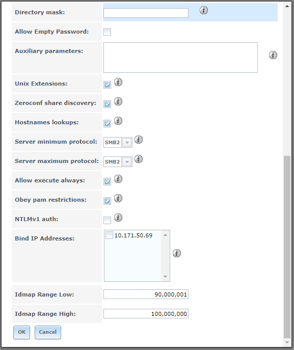

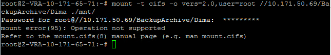

we've encountered this problem when setting server minimal SMB version to 2.0 or 3.0 :
the mount will fail when specifying the exact version as the minimal.
i.e. it seems the server checks client_version > min_server_version instead of client_version >= min_server_version
example config + failure :

Which version of FreeNAS are you using? That looks like 9.10. Which distro/version of Linux is in use?
I am using FreeNAS-11.0-U2 (e417d8aa5) .

In both FN 11.1-U7 and FN11.2-U3, the min server protocol defaults to vers=2.0 which is SMB2_02 and an up to date linux client cifs mount should auto-negotiate the highest version, unless you specify it as mount parameter.
I do set the version as mount parameter. I am setting it to ensure we fail to connect to 1.0 server.
You could check the output of testparm -s on your FreeNAS server to actual protocol values. Also the output of smbstatus for the running version of Samba and any connection info.
What reason do you have for restricting Samba connections to vers=2.0?
I allow both 3.0 and 2.0, I start by trying 3.0 and if it fails fallback to 2.0. as I said, I implemented this poor auto negotiation because I wanted to avoid connecting to 1.0

@yoavmorag Your first post screen grab showed you had set both min & max to SMB=2. If all you want to do is to avoid SMB=1 in the version of FreeNAS you are using, why not use the drop-down list to set min to "SMB=2_02" or "SMB=2"_10" and set max to "SMB=3_11"?
The thing is, I generally have control only on the client side. The screenshot is from a qa lab I own, but in the general case the user owns the server.
I declare my client supports 3.0 and 2.0, but if the end user has freenas and configures minimal ver. 2.0, my mount will fail, despite specifying 2.0 as well.
You're not specifying minimum version 2.0 on the FreeNAS, you're specifying SMB2, which is SMB2_10. This is documented here: https://www.samba.org/samba/docs/current/man-html/smb.conf.5.html#SERVERMAXPROTOCOL
