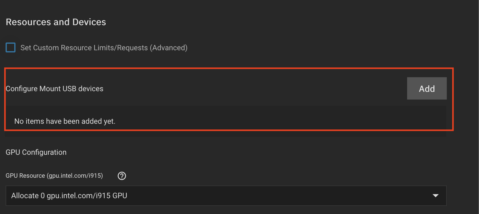

9,700
I assume the limit of not passing into a VM would also apply to docker containers as well?
I think that is actually an option now... at least for TrueCharts apps...
I haven't tried it personally, so can't report on how well it works, but you could get support over on TrueCharts' Discord if it doesn't. I found them to be quick and very helpful so far.
