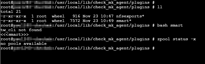

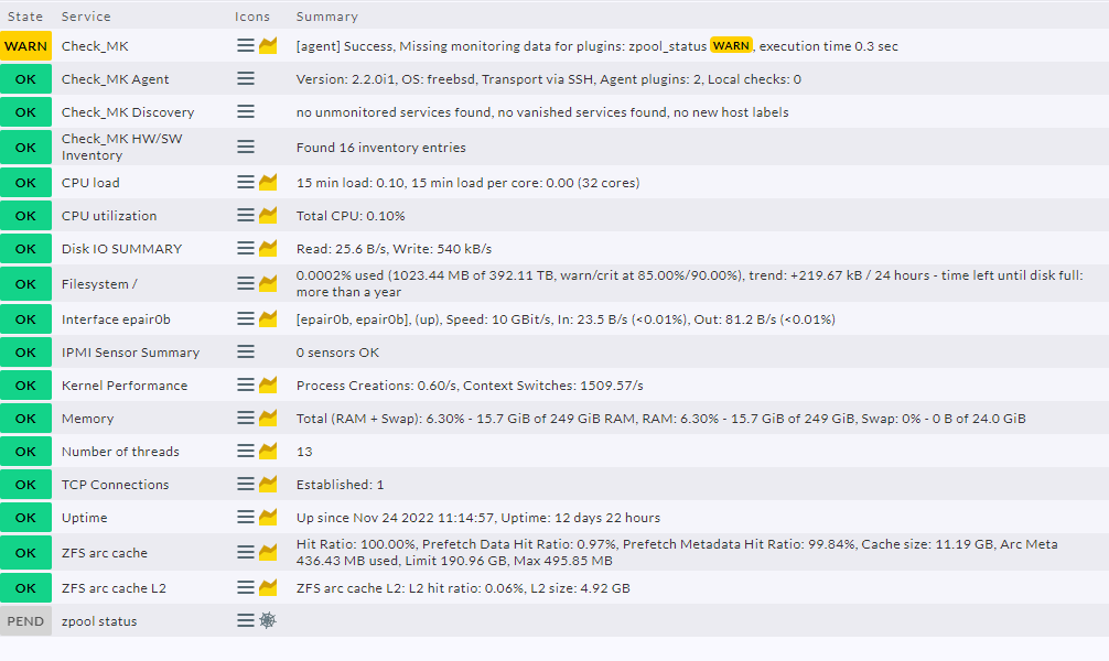

We are having some problems getting this to work. What we have is:
  • TrueNAS Core 13.0-U3.1
  • Created a clone jail based on FreeBSD 13.1
  • NATted port 2222 on the host to port 22 in the jail
  • In the jail properties, set "devfs_ruleset" to "0"
  • Installed:
    pkg install ipmitool libstatgrab bash python3 wget
    pkg install sudo
    pkg install smartmontools
    pkg install lsblk
  • Installed agent:
    wget -O /usr/local/bin/check_mk_agent https://checkmk.io/3EjKJlt
    chmod 0700 /usr/local/bin/check_mk_agent
    check_mk_agent | more
  • Enabled SSHD and set CheckMK server to query using ssh (Setup - Agents - Other integrations - Individual program call instead of agent access)
What we get is:
How can we make zpools on the host visible?
How can we make SMART work so we can monitor the disks?
Can someone give a more detailed description on how to monitor TrueNAS Core 13 using CheckMK via a Jail?
Thank you.
ggruber
Mar 8, 2022
5
Hi hp.prst,
did you transfer your software you grabbed in the jail to the host system?
I think you will not see the host's zpools from within the jail.
Similar for the smart plugin, but this needs in addition some tweeks to work on TrueNAS.
Possibly I could send you my version.
Regards
Gerold
This is not the correct way to do this. TrueNAS is an appliance OS, and the base firmware is not meant to be modified in this way.
Instead, it would be prudent to allow the jail to ssh into the main system to run commands such as "zpool status", which is going to be much better supported, and will survive updates, upgrades, and even reinstalls. The basic idea is that you turn on SSHD, allow root logins (probably), set up an SSH key in the jail, allow that on the NAS root account, and then from your jail, make sure that you are able to execute "ssh root@mynas.host.name zpool status" and see that it puts out the same results as "zpool status" would on the NAS itself.
