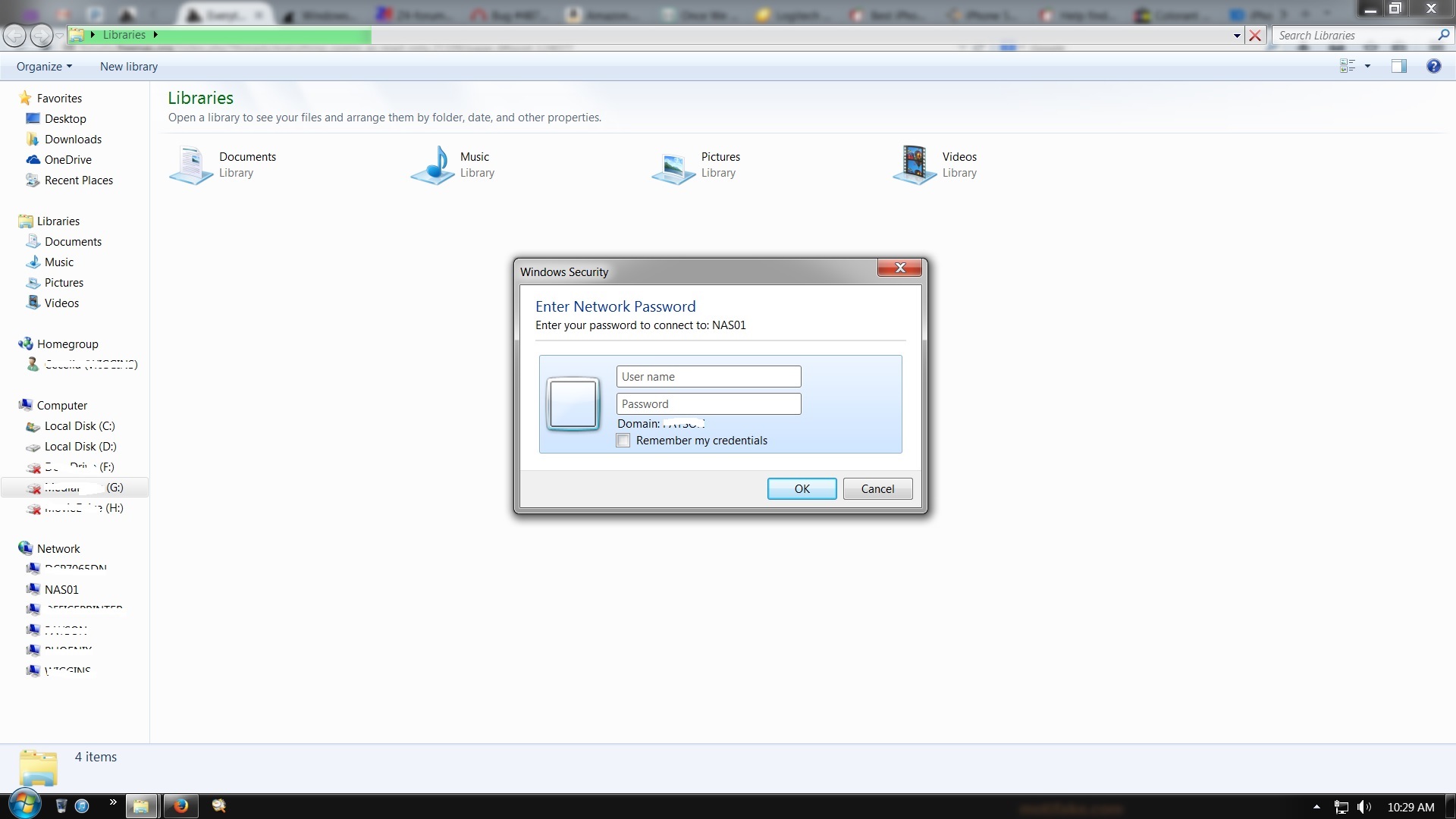

I have everything working again, however this time around I have it setup so that a password is required to access the NAS (I did not enable the guest account). However, for some reason the Windows systems keep requiring I re-enter the user and password when I reboot. When I mapped the drives I told Windows to save the credentials, so I don't understand why I keep having to re-enter them. Shouldn't it just automatically reconnect using the "saved" credentials?
Typically, I just set the FreeNAS credentials to be identical to my windows credentials.
Does the problem occur if you connection via ip address (i.e. \\192.0.1.5\Share)?

Just tried connecting via ip address and I get asked for my credentials. I don't use a password on my Windows machines, so that wouldn't work in my case.
Attached is a screenshot of what occurs on initial reboot of my Windows machine. It's like it does not remember any of the credentials.
