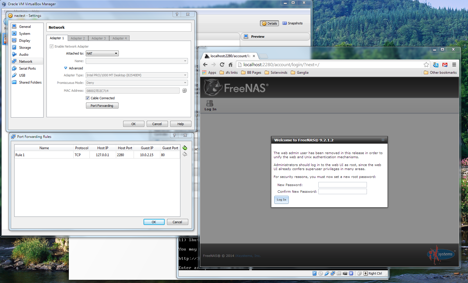

If you still want to try VBox and want to use NAT, here you go
Go to VM setting, select Network, and click on Port Forwarding. Set up a route showing in my picture and now you can access using localhost and port. I picked port 2280, you can pick whatever you want. If you setting up HTTPS, you will need rule for port 443

Wow, thank you for going through all those steps, alexg. I've managed to get my VirtualBox set-up working now. :D
And thank you again DrKK for your advice. I look forward to discovering more of FreeNAS. :)
