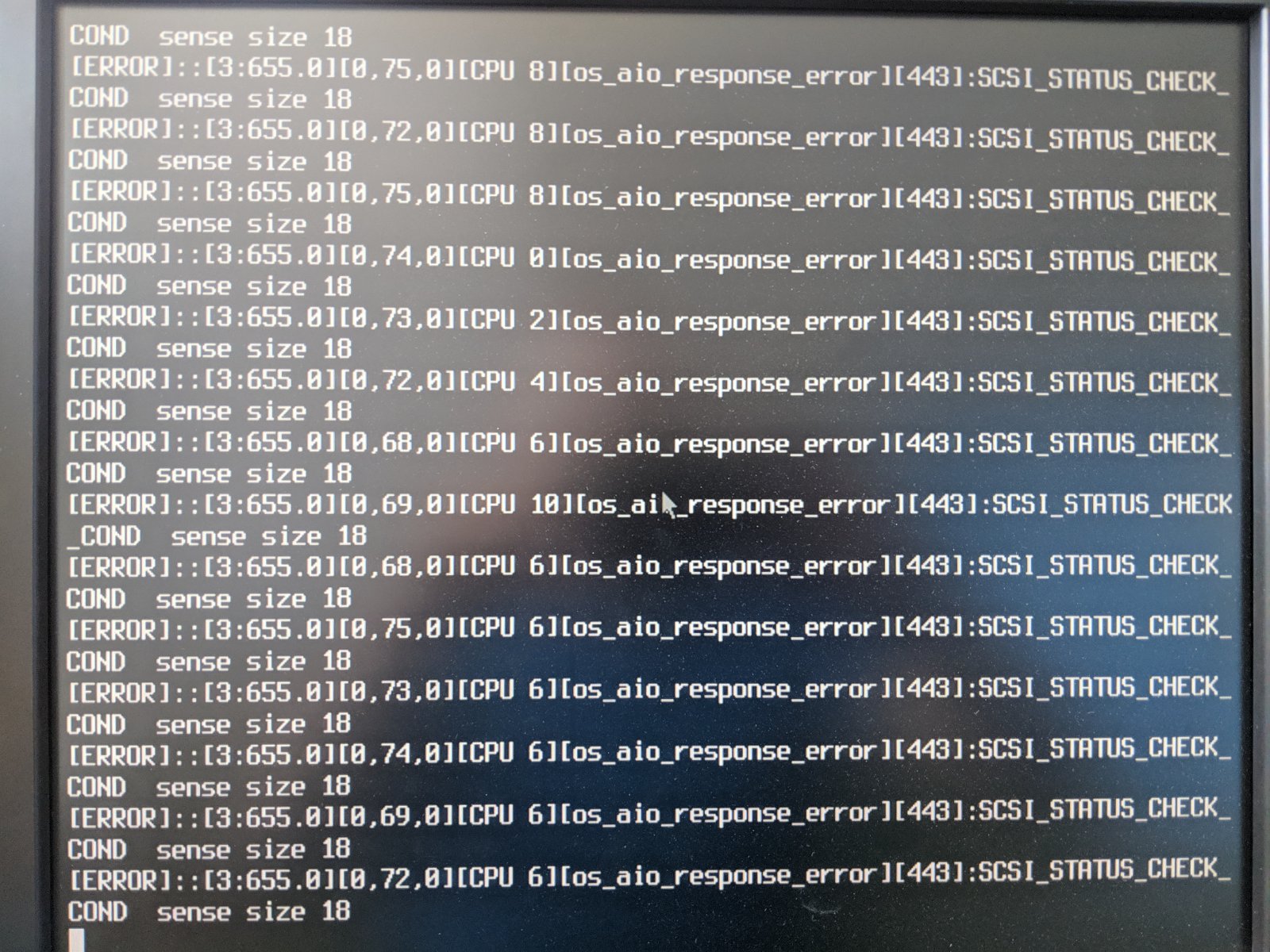

2. After the driver installation and a reboot, the monitor on the FreeNAS system shows some Errors which I don't fully understand, and I am afraid to go further with the FreeNAS configuration right now and put data on it, there are different line which say something like this:
[ERROR]::[3:665:0][0,75,0][CPU_8][os_aio_response_error][443]:SCSI_STATUS_CHECK_COND sense size 18

Manually installing drivers for storage is way outside the support scope.
You have chosen hardware that will not play well with FreeNAS and will probably get little or no help here because of that (none of us have any experience with trying to make that card work with FreeNAS and probably also have no interest in doing it).
You should get your hands on an LSI card as recommended in the hardware recommendations guide (see the resource section, but here's a link directly to the resource I'm talking about Hardware Recommendations Guide).

Should I continue, or should I consider to build my dedicated storage with another OS like Linux, which will work better with the RAID-Controller?
- RAID-Controller: Adaptec SmartRAID 3154-24i in HBA-Mode with Zero-Maintenance Cache Protection
FreeNAS uses Software RAID through the ZFS file system. You need to remove this hardware RAID controller and get a SAS HBA instead. The LSI products are well supported in FreeNAS.
Why are you using a 24 port card? I can make a suggestion for an alternative.
Probably because you are not supposed to install drivers in FreeNAS and you broke something.

but we already bought it,
Sell it and get some money back. IT mode SAS HBA controllers are not very expensive.
and I thought, when it works in HBA-Mode it could work out in the end.
Except that there is no driver support for it in FreeNAS and although FreeNAS is based on BSD, it is not a regular server, it is an appliance that is not intended to be modified by the addition of drivers and even if you do load the driver, as you can see, it still is not going to work properly.
What would an alternative cost?
No point buying more than eight ports, just use a SAS expander to break those ports out to more drives later and SAS expanders are relatively cheap.
